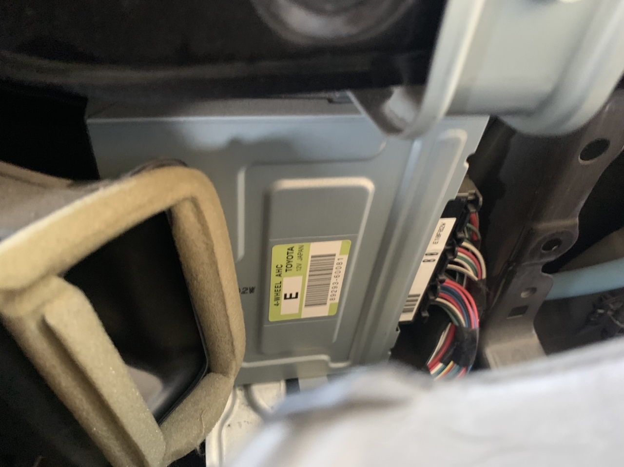

No change after disconnecting the battery for about an hour. Today's mission is to find the ECU. I found where it is on a diagram (right where lx200inAR said it would be), but not sure yet how to access it.
was worth a shot.
The ECU is actually a bit behind that white junction box in the video, pretty much directly behind where the third row seat folds up. It requires pulling most of the panel off.
What I’m concerned about is that it looks like someone frustratingly designed this to not be able to remove the harness plug without removing the ECU itself. I haven’t actually tried to wiggle it out but it sure it right up next to that bulkhead.

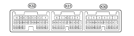

My brain hurts. I'm using this from the FSM, as far as I know I'm checking the correct ones.
Will try again in a bit.
I assume you are flipping them mentally, since i would guess those labels are referenced from the ECU. So if you were staring at the plug, everything would be mirrored left to right.
