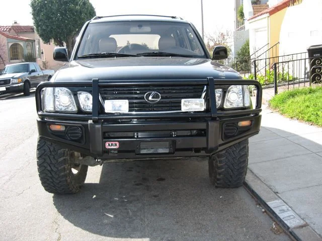

You could fit the ARB sahara bar with no mods or gaps.
I really like the all white. I have been thinking of doing my LC the same, with the removal of the trim color. That one turned out really nice.
can you tell me how and what you did to the ARB turn signals? I like that a lot, just LED bulbs or did you change the unit out?
thanks
What I used was Toyota Hilux 88-98 Altezza Front Bar Clear Light ebay # 110563013277 and 6 LED DRL White Day Running Lights such as ebay # 160456499058 which I have inserted inside the hilux lights, so this way you have the white led lights and orange/ amber turn signals all in one. And when they are off it just looks clear.

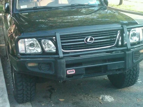

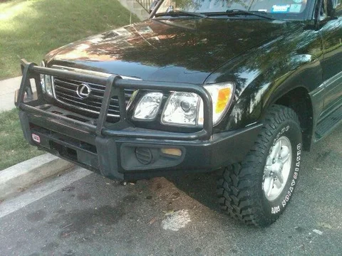

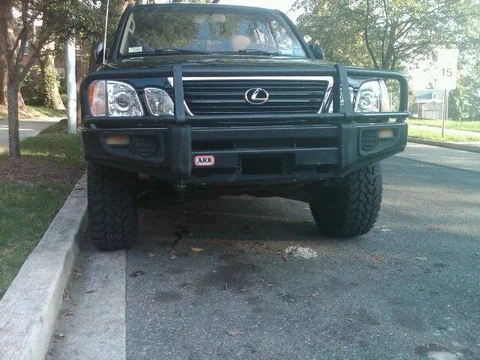

Here it is. Apparently the previous owner bent the frame, tow hook and a few other things because it took some grinding and pounding to get it on. But i love it; thanks Les.
