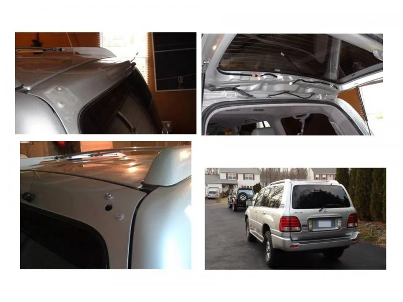

Finally today I removed the whale tail spoiler from my LX470 2006.
It was faster than I expected, now I need to order the new center stop light and figure how to plug the holes.
I would like to get some Ideas to plug the holes, please. (if including pictures, better)
Yes I could go to the bodyshop but this will be my last option.
Here my 2cents to the MUD community
Some pictures and the FSM procedure (ET-8)
“1. DISCONNECT CABLE FROM NEGATIVE BATTERY TERMINAL
2. REMOVE REAR SPOILER
(a) Using a screwdriver, detach the 4 claws and remove the 2 rear spoiler covers
(b) Remove the 2 bolts.
(c) Put protective tape around the spoiler.
(d) Insert a piano wire between the vehicle body and spoiler.
(e) Tie objects that can serve as handles (for example, wooden blocks) to both wire ends.
(f) Pull the piano wire and scrape off the double-sided tape that holds the spoiler to the vehicle body.
(g) Slide the spoiler in the direction of the arrow and detach the 2 clips. (up and front direction)
(h) Disconnect the center stop light connector.
(i) Remove the spoiler.”
With mine, it was not necessary the piano wire (red lines), because the spoiler not was glued at all, I would suggest try to slide it, if it is glued, follow the above procedure.
It was necessary to remove the garnish of the back door, in order to remove the segment of wire between the spoiler and the main back door wire harness.

Wow, by comparing the first two pictures you can really see how much that thing weighs! :D
hehhee is funny, but i just remove the spoiler after the lift been installed, and it need some load on rear.

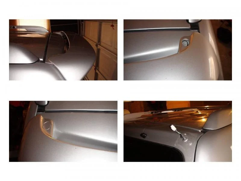

I pulled my tail off today. Maybe I shouldn't have but I also pulled off the plastic retainer rivet things. I tried to find some plugs that would fit at the auto shop but didn't find anything I liked. I'm going to go to a specialty place Monday and hopefully I'll be able to get it worked out.
The hole from the electrical plug (which I had to shave the plastic down to get it pushed through the hatch) is about 5/8" and the holes from the plastic retainer things are about 3/8".

I just used the hex heads that were holding the spoiler on and added 2 new rubber seal washers. I plan to pain them white. I have yet to figure out how to plug the wiring hole. For now I just left the wire and gasket incase it rains.
How did you remove the to plastic. Rivet retainers? They look like they are pop riveted on.
I re-installed the hex heads for now like you but didn't add any rubber washers, I ought to though. I'm hoping to just find a rubber plug that will fit the hole from the wiring but need to get to a bigger parts shop.
I removed the rivet things with some pliers, basically I just broke the top part off and the bottom part fell down into the door. Had I known that was going to happen I would have broken the part with the hatch up then tried to fish or jiggle it out.
My paint is pearl white so its the fancy three stage stuff so I think I need to either leave it black or get a real good color match to make it look good. Plain white paint on my rig would look worse than just a black plug I think.
