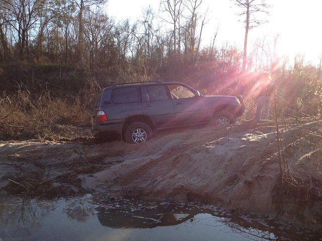

Here is a bad photo of K9crazy stuck per my post above, her Ironman worked well once we operated it correctly and used a snatchblock:
(Sorry Heather!)
When your axles and frame are dragging in the mud like that, a snatch block is a must. With that said, 16k lbs or 24k lbs will get you out just the same.
Getting stuck in mud requires a greater duty winch than getting stuck in rocks. Snatch block, D-rings, tow strap, tree saver, and gloves are mandatory.
