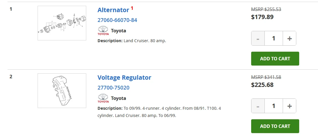

What sucks is that you can get a new Toyota alternator for less than the cost of a new voltage regulator for the alternator.
