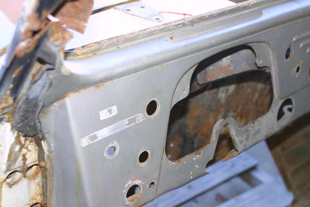

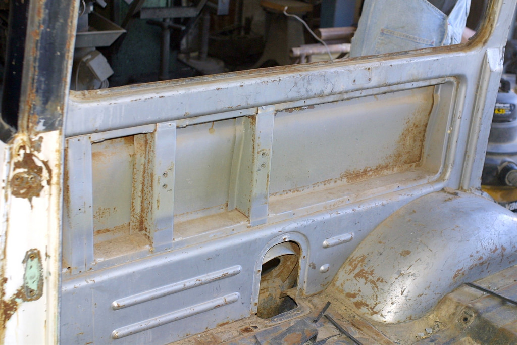

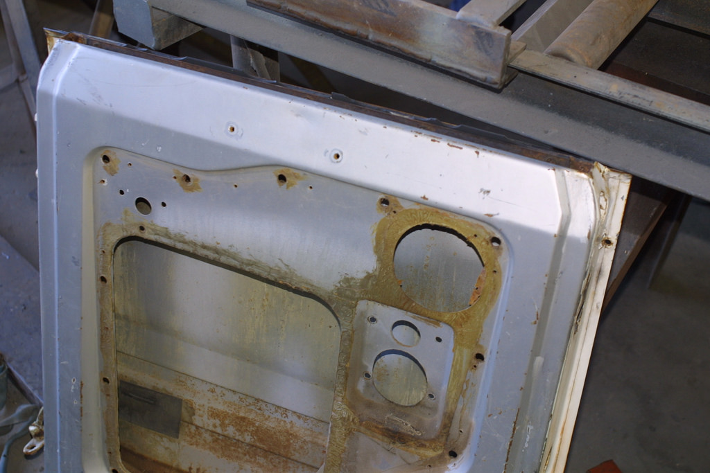

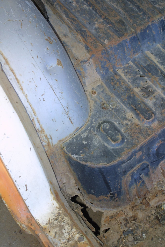

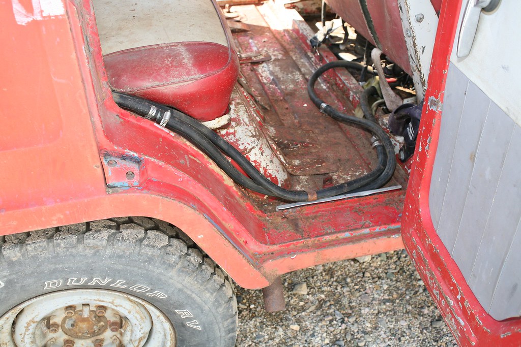

Can anyone give me some guidance on what the original color scheme might have been on my '67 FJ45LV?
I have seen many white interiors on restored vehicles, and my '67 looks like it may have originally been white as well.
I do have two other examples, a '66 and a '64, that have the following scheme (see photos below):
-Floor is flat black
-Inside doors are Silver-Grey
-Rear inside panels and wheel well are Silver-Grey
-Dash is slightly different tone Silver-Grey
Interior of '64
'67 FJ45LV
Thanks,
Mike
