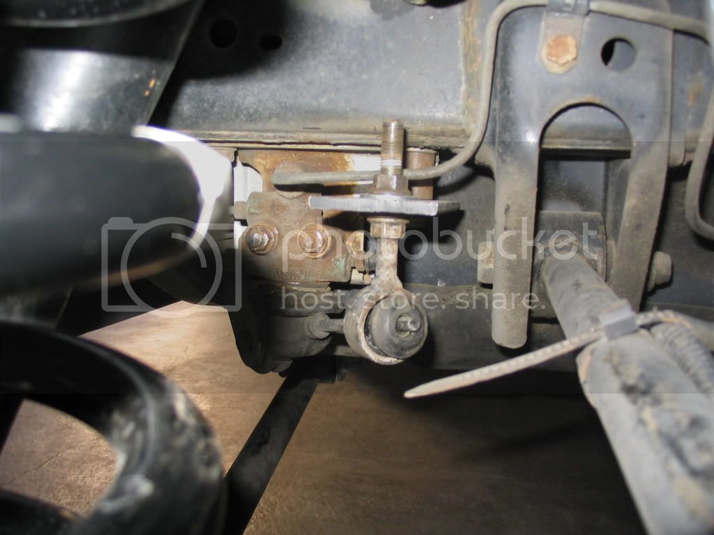

LSPV nightmare solved, kustom mount w/pics

Can you post pics of the clearance between the rod and the left rear UCA?

This is my solution. I made mine adjustable to give more braking to the rear. The fronts still lock up first. This is an old trick from the now defunct AOR, or Advanced Off Road in Grand Junction. It always worked well for them, especially when you are descending down rock drops and such, to give more brake distribution front to rear in those conditions:

Finally took some more pics
1st... Vehicle unloaded. The rod is about 1/16-1/8 inch away from the UCA. With spare tire, and 300 lbs(my springs are rated for the extra weight), the rod moves further away, but not a whole lot.
2nd pic.... DS wheel stuffed. The rod moves further away from the UCA
3rd pic...DS wheel at droop, with as much articulation as my driveway could provide. The rod contacts the UCA
I have noticed that the rod pivots down when it contacts the UCA, relieving the strain. I've wheeled it a few times, and it hasn't broken yet. I think I'll just keep driving it as is till it breaks, if ever, the braking/handleing improvement is worth it. I may try to modify it in the future so there will be no contact at droop, and I can still always remove my mount if I go on any longer real wheeling trips. Its an imperfect solution, but i have bigger fish to fry

As some of you may recall, I was having trouble moving my LSPV down to adjust for my lift. Instead, I fabricated a new mount for the valves armature at the rear end. I wanted it beefy to limit flex, so its made from 1/4"x1" wide steel, the 3/8" holes are spaced exactly 1" apart.
From measurements taken before and after the lift, I gained exactly 3 inches with the OME 863s in the rear. Therefore, I made the second set of holes exactly 3 inches higher than the first. Its bolted up with stainless hardware(takes twice as long to rust), and has two coats of primer and two of rust guard black, I went all out.
Didn't think I would see a difference in an unloaded vehicle but hold on to your iced mocha ladies, she stops like a porsch, kinda. Braking is definitly improved, there is less nose dive, way more control while laying on the binders, the back end stays in the back and doesn't feel like it wants to come around front.
This doesn't make a lot of sense to me, but it feels like the truck rolls easier. The first time I engaged reverse to pull out of the garage I rolled backwards, which I've never done before. The truck accelerates faster, and i'm watching the milage to see if it improves. Is it possible that the front brakes were so biased they were ever so slightly dragging? Sounds crazy I know, but it feels different, I bet my track times will improve.
