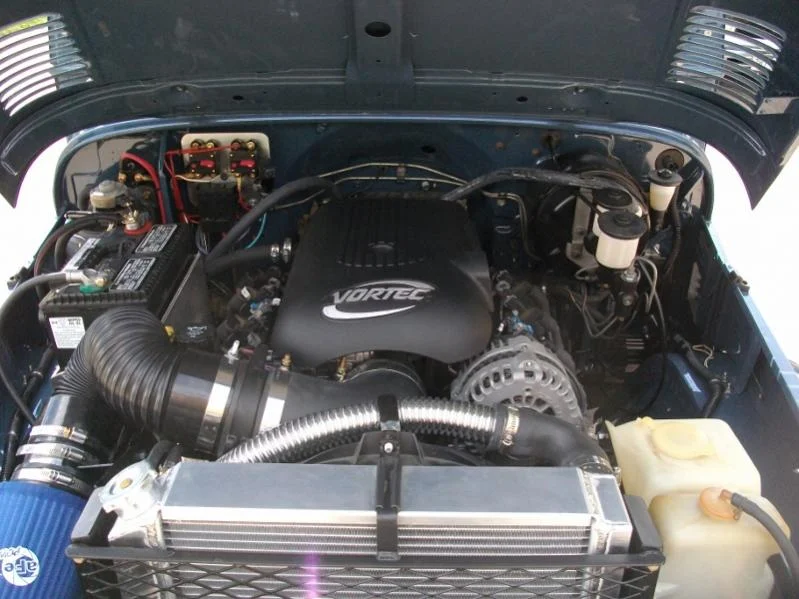

I used the hose terrx showed above for my top hose, along with a 90 I cut from a whole hose I had. For the bottom hose (from a 1978 40), I cut down a stock hose and it fit almost perfectly. I did shove a spring in it to keep it from collapsing.
attachment.php
