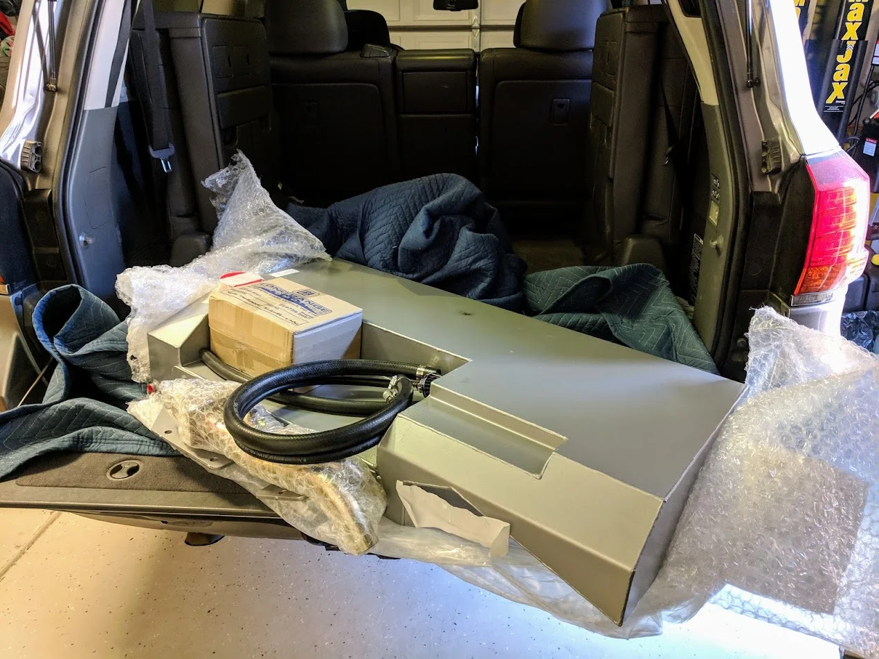

The LRA aux tank is modified and adapted to the USDM 200-series as it has a relief cut in it for the charcoal canister. This does reduce capacity from the original ~15.5 gallon tank. The charcoal canister does not exist in Australian market 200-series.
This is the upper side of the aux tank. Notice the cut-out where the hose and box are sitting.

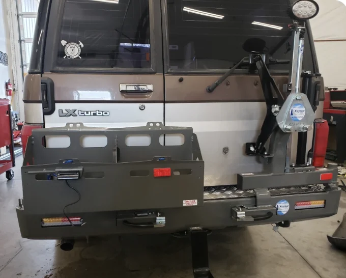

Our new "show truck" - 1991 LJ 77 from Spain, getting some love at North West Toys in Monmouth, OR (near Salem). Yes, that's a 39.5 gallon LRA tank and a KAYMAR bar/carrier system:
