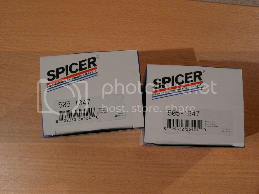

So I finally received the lower ball joints for the LC100. After many phone calls and much waiting, they arrived today. They are a Spicer 505-1347 and cost me $62.00 CAN each. I will be looking to replace one in the next few days so I'll post how it goes. The parts guy I got them from was surprised that Spicer was making anything for imports and had to ask his rep to locate the part in Toronto as his parts books didn't show that it existed. The last picture is a little tag that was included in the box that may be useful to someone.

Part number and prices appreciated if possible Spressomon
I think Spressomon's talking about the CV boot kit. I did this on my '86 4runner...about $30 for the kit (both upper & lower boots incl. the grease). The ball joints are a different part. The ones on my '86 (both lower and upper) are greasable via a little hex bolt while the ones on the 100 don't have this bolt.
That 260-1636 is a Napa Chassis number. It shows I have two sets in Seattle, and there is a bunch of sets scattered around the USA
Napa likes to take other brands, rebox them, and mark them up ;) Like their wix filters, are in napa boxes, and marked up. It's all about brand name. HOWEVER, Napa does have a lifetime warranty on all first line chassis parts, which may be why you pay a premium.

You can get Spicer stuff almost anywhere, Autozone, Checker, etc. Just use the part no. on the box. What makes you think you need to replace the ball joint?
