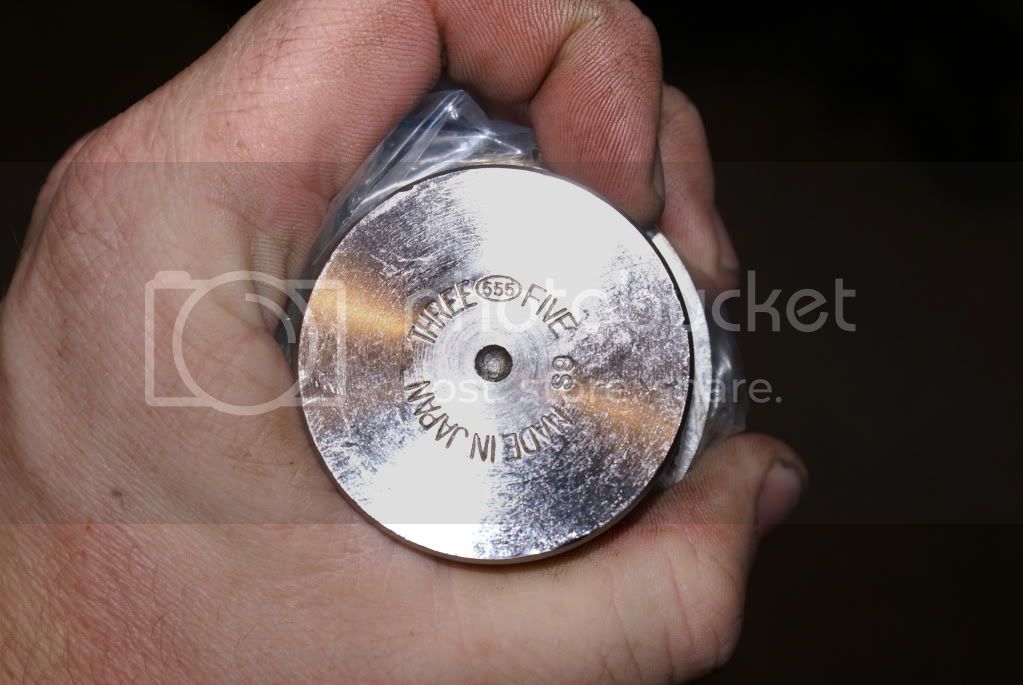

Yep - I pressed the spicer joints into the lower arms about 2 weeks ago. They fit great and are good quality - the ones I found are made by Three Five - in Japan - they make good stuff.
The only issue I had was that I had to remove the boot on the new ball joint to get a good surface to press it into the lower arm - then once in I put the boot back on. Had to be careful not to tear the new boot - which wasn't too difficult. They seat into the arms very well. I've had no issues and the front end of my truck feels tighter. There was about 1 inch of play on the driver side and 3/4 inch of play on passenger side.
I ordered the spicer joints from rockauto.com - but these raybestos joints came. I was fine with the change - actually seemed like an upgrade after I saw they were Three Five.
