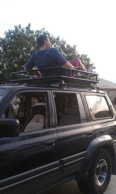

Can u make your own or have someone help you? I built my own with some thought and made 6 for about $30. And they are sturdy as I can stand on my rack.

The complete rack weighed in at 52lbs and the length is from the back edge of the sunroof to the rear spoiler (hatch open) I cant remember what it was in inches. It is possible to place on the roof alone but I would recommend having a second person.
As for strength, all 210lbs of me have stood on every edge of it, even on the curved tube and it has no give at all.

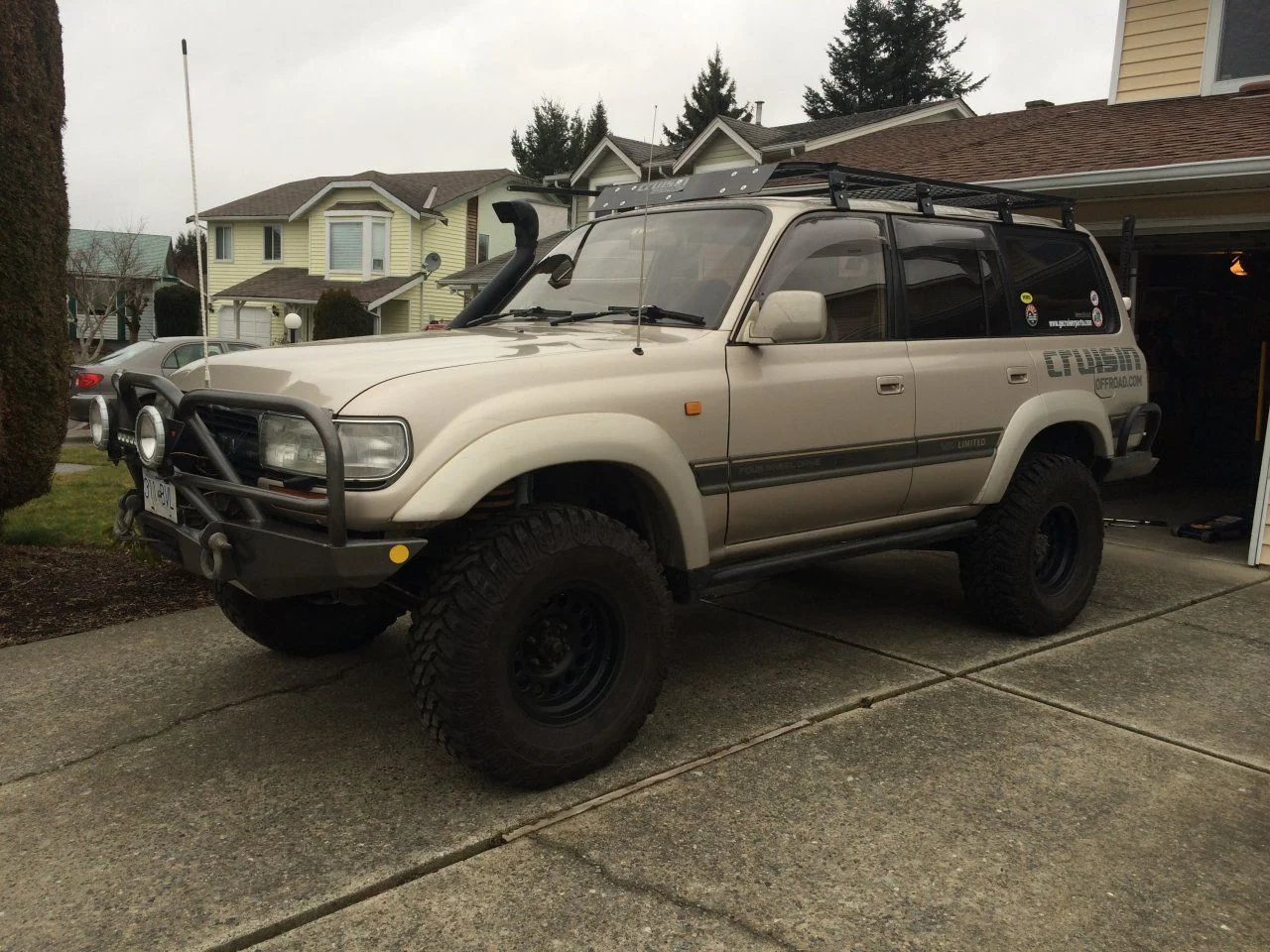

Who makes this rack?? It looks nice and clean with little wind noise
