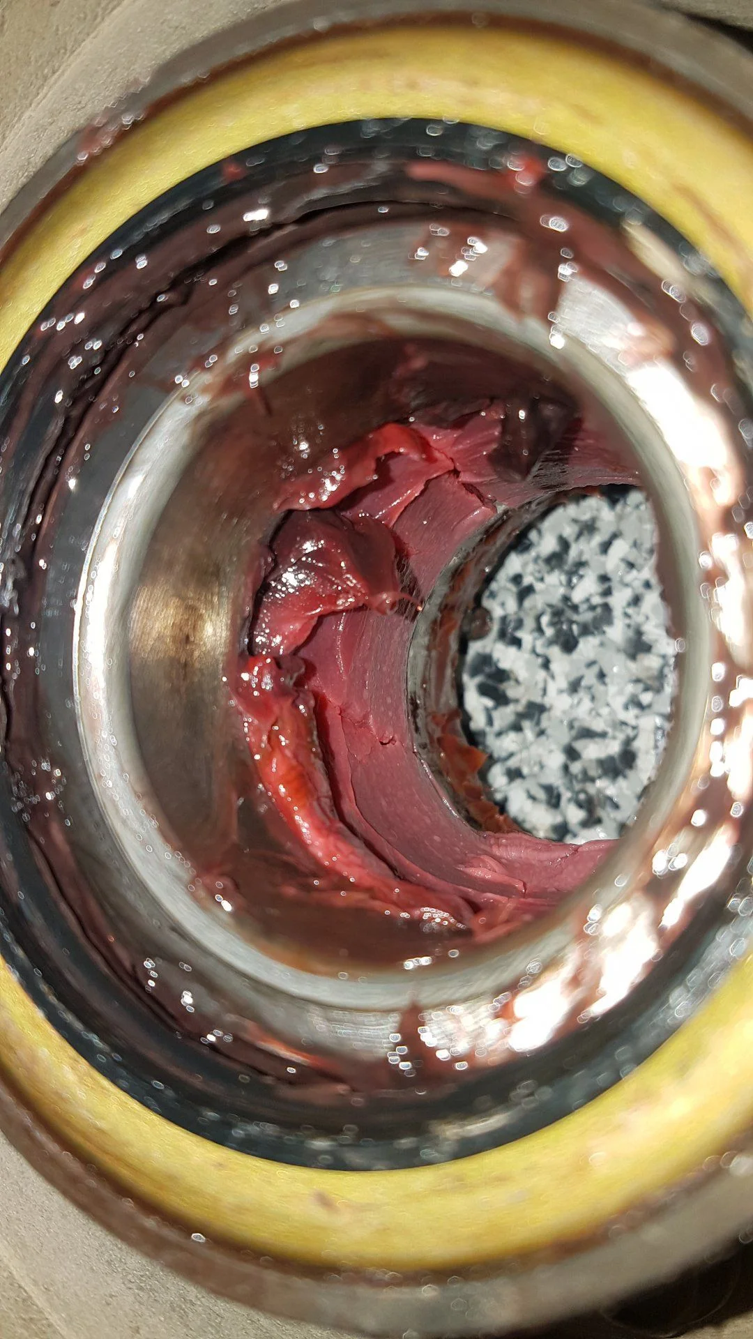

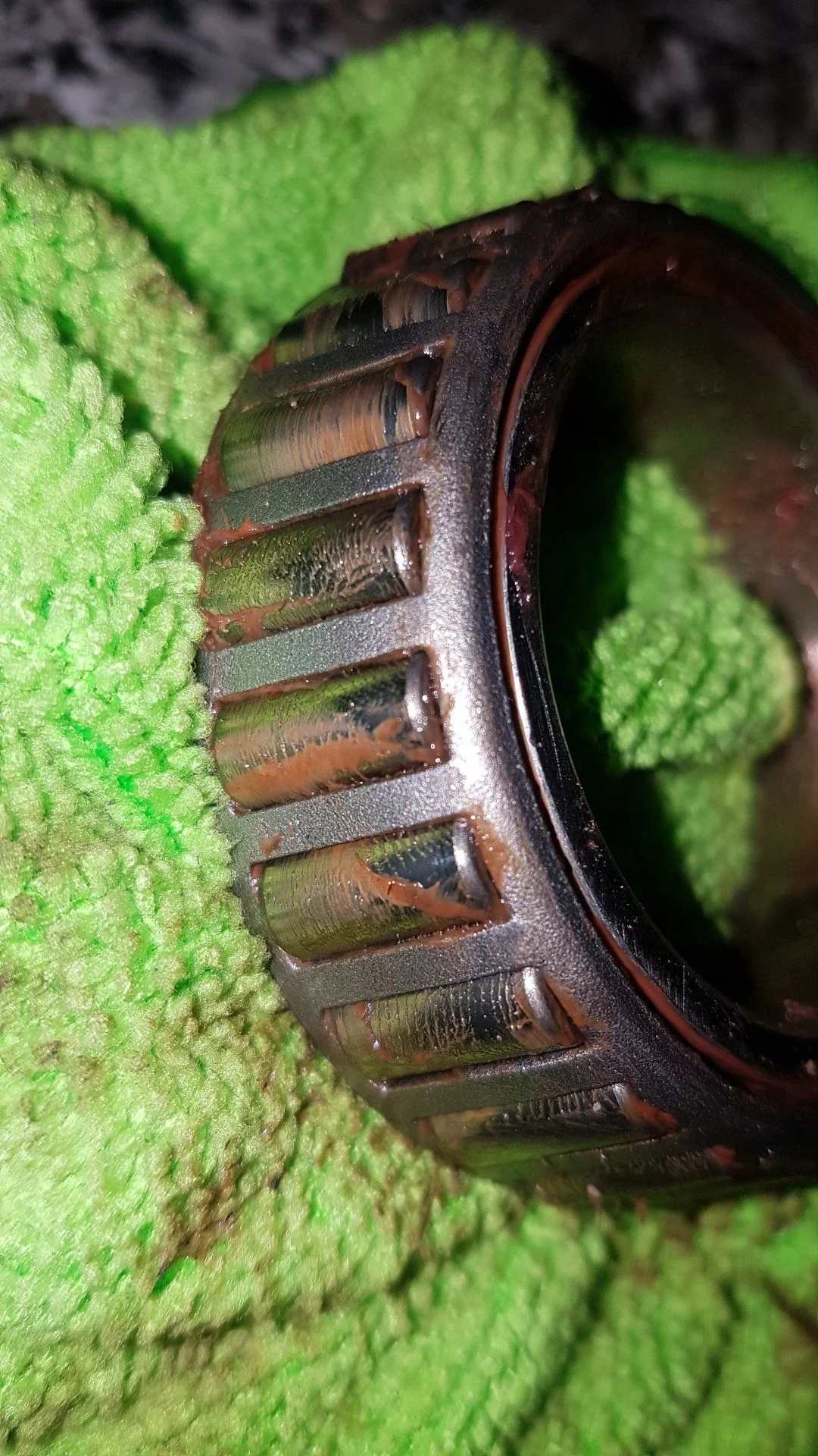

I tore down the axle and it looks fine to me, however I dont really know what I'm looking at here as it's my first time delving this deep into the front. I got the outer bearing out and It looks good to me, the shaft that looks good and there arent any indents or grooves, I havent touched the inner bearing yet as i dont want to mess with that seal unless I have too but it looks ok to me.
However, when turning the CV axle, the shaft that extruding out the side is making some metal on metal noises. Since the hub isnt on, I am thinking it just isnt centered so it's making contact with the sides, but I may be wrong.

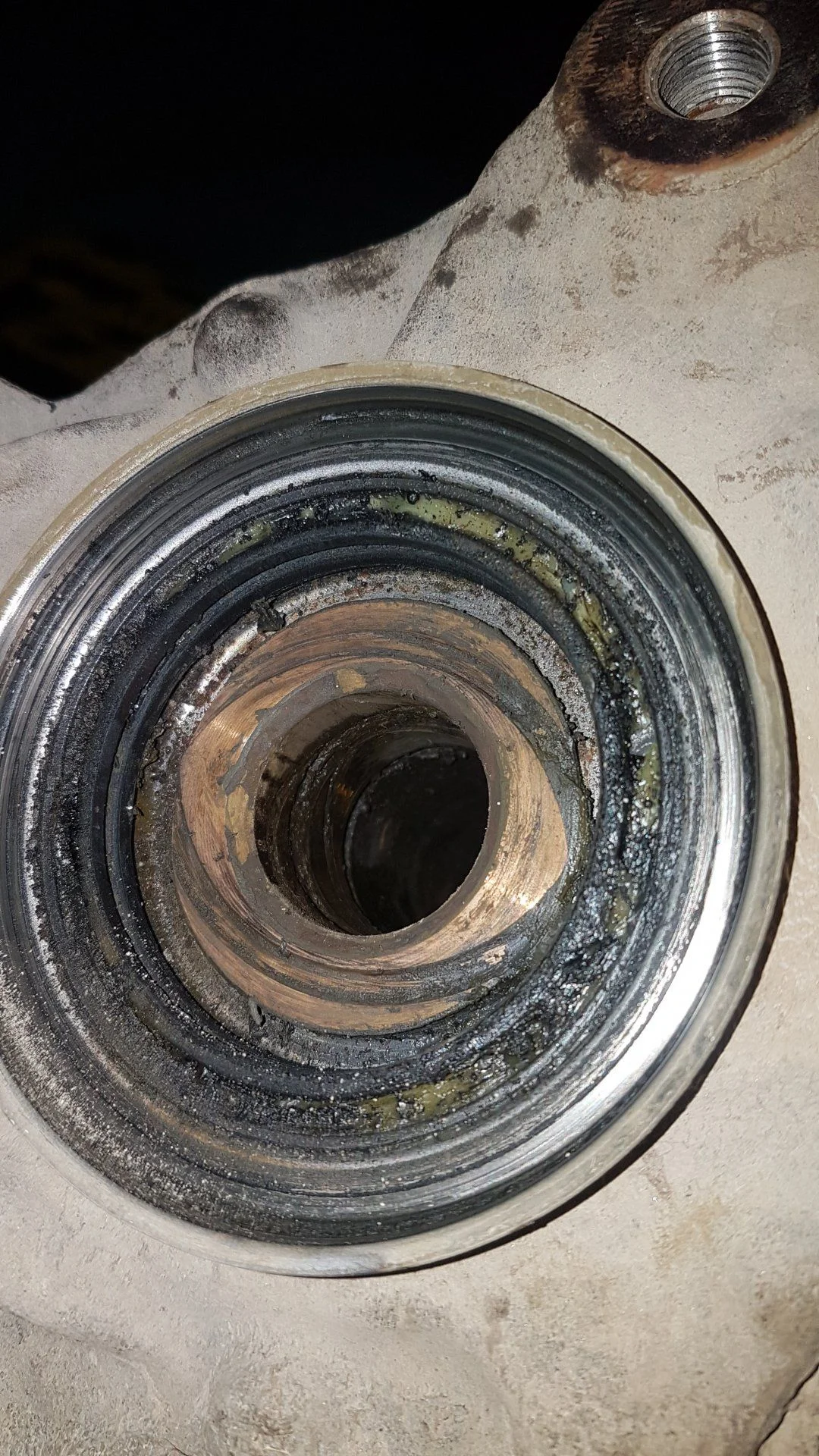

Opened it up a bit more. The shaft of the CV axle doesnt have any grease on it (it looks like there is a bit of water in there too). And there are some weird coppery looking flecks on one of the sections, and there is a copper plate with weird looking grooves. It almost feels like dirt is inside the shaft as well.Is this normal?

Mine generally don't look like that when I disassemble them. Were the boots on correctly? Last three shots look problematic to me, especially the out of round grooves in the last shot. Been at least a year since I pulled mine, so going on memory. Was reassembly done in the right order, with the lock washer tab bent down? There is a pretty good diagram of that in the FSM, IIRC. Nice impact wrench, by the way.
A very good shop locally installed them a while back (EBI, i see you are from van as well). So i am assuming that they were installed correctly. Those grooves look machined though. the ones on the outside of that copper part, and on the inside of it. Too perfect to be a rock or something scraping it.
And the impact is my brothers. Having family involved with car shenanigans is nice because you only half to buy half the tools.
Yes, I have been to EBI. They post ads for parts pretty often. All three of the last pix are from the sideshaft? Mine are usually filthy, but not dry looking like that. I tend to get grease everywhere on everything when I pull the shafts. True, it doesn't look like a rock got in there.
Unsure on the correct terminology, but on my last post with pictures, the first 2 of the shaft is the CV axle, and the 3rd shot is looking at the chunk of metal that the axle slides into (The piece that the balljoints connect to)
Because there no fûcking lube on it and its eating itself. The grooves in that bushing are for grease, not dirt and water. The spindle bushing was causing the noise. I recommend replacement of that one and inspect the other side before it repeats.
Thanks for the help gnob. I'll get a new bushing installed and report back if that fixes the problem or not.
Also i agree with the locking hubs. This repair really showed me how much better locking hubs would be.
EDIT: Here are pictures of the inner spindle bushing, it looks pretty chewed up. Im assuming rocks or other debris got in here and caused it to do this.
EDIT#2: Just realized that those deeper grooves were probably caused with my hammer and screwdriver knocking it out. But there are a ton of small grooves inside so i am gonna replace it regardless.
