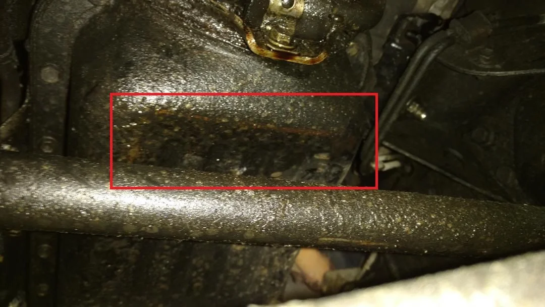

I noticed i put a small dent in the oil pan. If i had to guess its maybe 1/4'' deep and 3-4 inches long. I've included a picture and outlined in red where i placed the wood and you can kinda see the dent.
Any ideas? I am assuming i've jacked something up inside the oil pan or engine.

That 'hollow' knocking sound sure sounds like something contacting the oil pan.
Can you place your hand on the pan with the engine running and 'feel' for contact?

I will check tomorrow. I found this thread. damaged oil pan while changing motor mount and it sounds exactly like my problem. Looks like i'll be dropping the pan and either getting a new one or hammering mine flat again. I would think the crankshaft wouldnt sit so close to the bottom of the pan that such a shallow dent would hit it.
UPDATE:
So it was the dent in my oil pan hitting the crank that was making the noise.
Over the past two weekends I've been working on it. First weekend i got the pan off and flattened out the dent. Today i cleaned it all up and put it back together. I originally tried to use RTV on the gasket and pan to get it to stay in place while i put the oil pan back on but it didn't want to stay put. So then i used some RTV and small zip ties and attached the gasket to the engine block then put the pan on. Worked like a charm and wished i did it the first time.
Now my only fear is i might have over tightened the oil pan bolts. I turned them till tight and then a 1/4 past that but after some reading it sounds like that might be to much? Hopefully not. Will find out either tomorrow or next weekend when i put oil in it.
