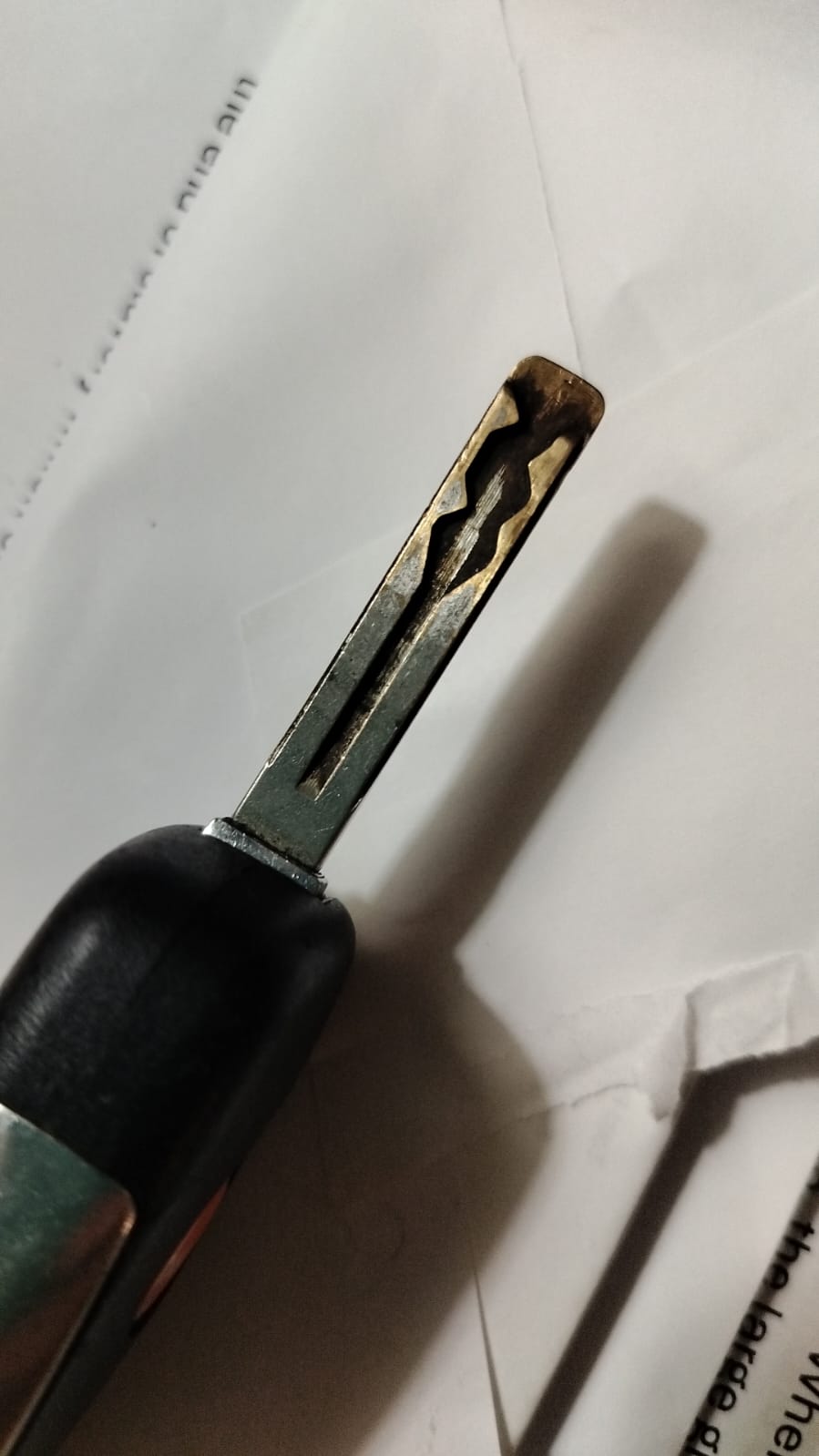

So last night my keys fell off the harness connected to my back pack which contained my only Master Key. The only key I have left is the "valet key or spare key" (see photo). I would like to get another master key without breaking my wallet. I saw this video Toyota Landcruiser 100 series 1998-2002 key fob programming. Is it as simple as buying a replacement programmable and just following the directions once the key is cut? If yes, what kind do are the most recommended.

I'd check and see how that key is actually programmed. "Master key" is simply that, how it was programmed into the ECU.
Insert the key you have into the ignition – DO NOT TURN ON. There are 3 possible things that may occur:
  • (a) Security light continues to blink = unrecognized key.
  • (b) Security light goes off IMMEDIATELY = MASTER key
  • (c) Security light remains illuminated for 1-3 seconds before going out = VALET key

Ended up finding a random guy who works at local airport and does keys as a side hussle!
He did the cut using a standard generic 3rd party key, and managed to get the immobiliser programming fairly easily too - although he took a lot more goes at getting the remote locking working. He pulled the driver's door lock, used that to make the physical, then a laptop to somehow program it after using the VIN I believe (or may have plugged into the diagnostic port - honestly can't remember exact method).
Cost me about $160 all in including one additional physical key (no programming) spare).
Sorry I can't help more, but here's picture of the fob / key he made if helps - pretty sure I've seen these at parts stores. Mine's a JDM model so not certain same as USDM.
Thanks for the followup. Since posting, I've also ordered a blank and am waiting for it to arrive. Also got TechStream and ordered a connector for the laptop. If that doesn't work will take to a dealer.
