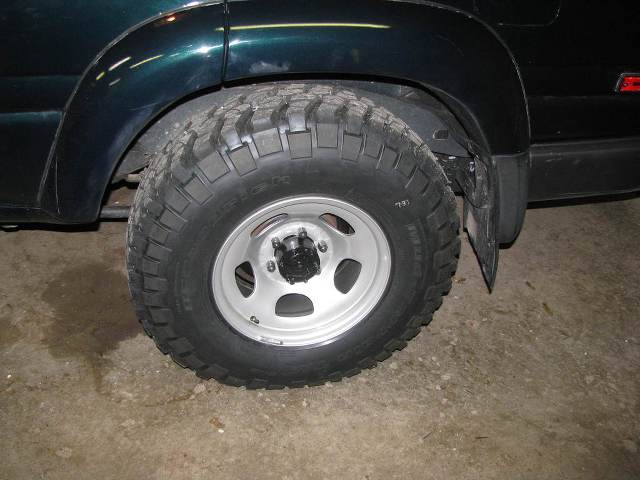

These are OEM Toyota 16x8 steel wheels, P/N 42601-60361.

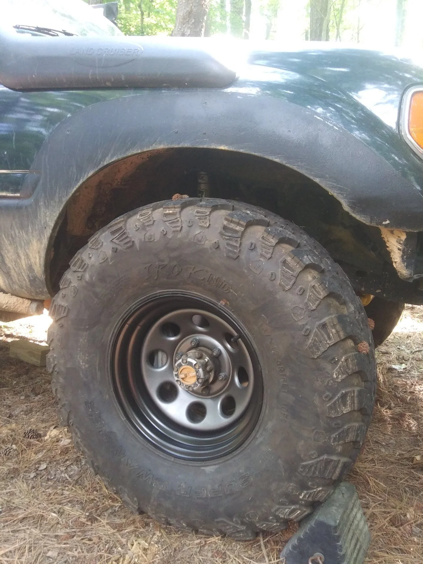

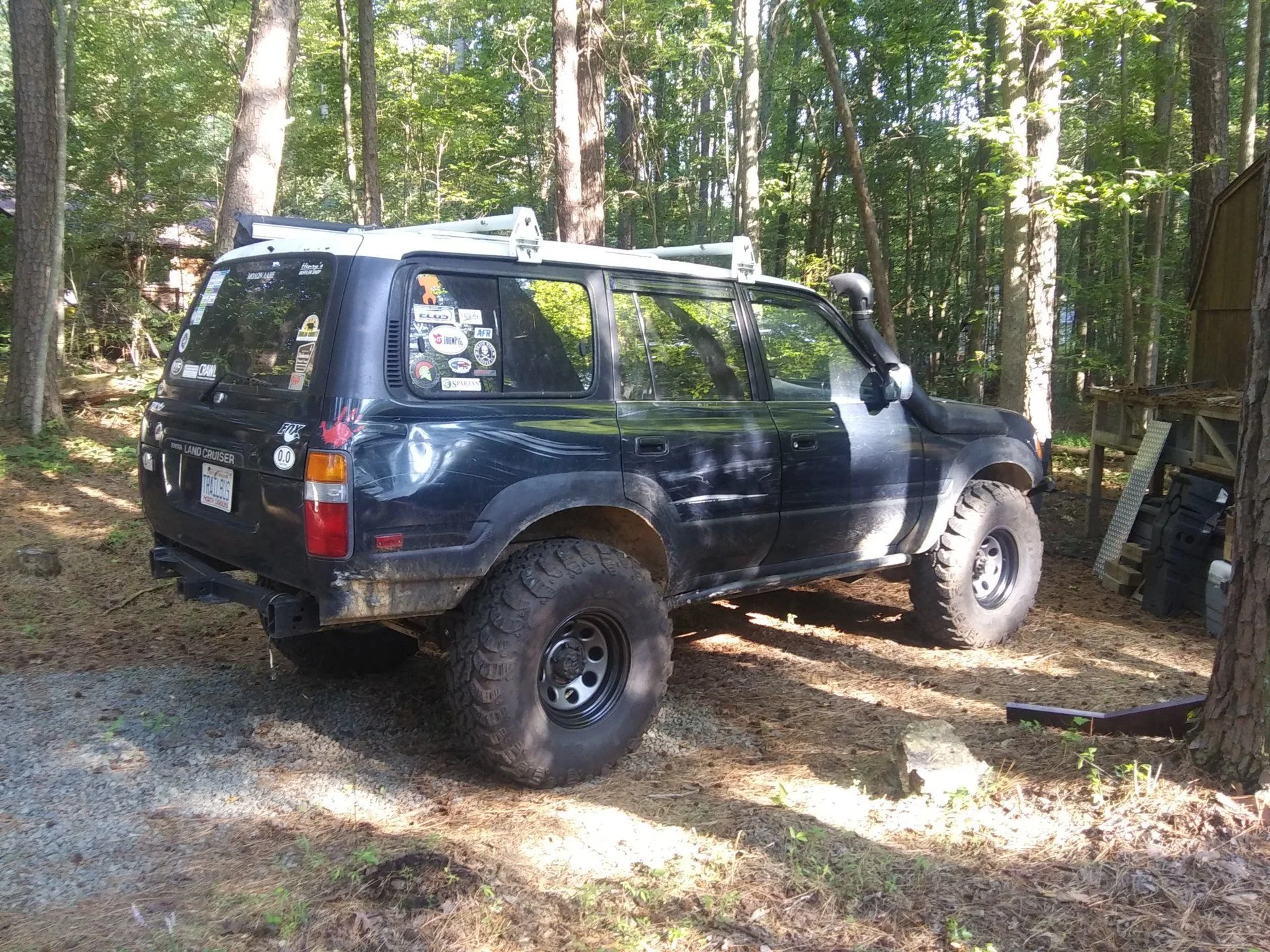

I'm running painted Tacoma steelies on mine with a 1.5" spacer, found em on eBay. I *think* they would fit without, but don't take my word for it as I run the spacer to make the tires are flush with the fender flares.

I don't love the idea of spacers, but they've not given me issues at all for the 8 or so years they've been on there.

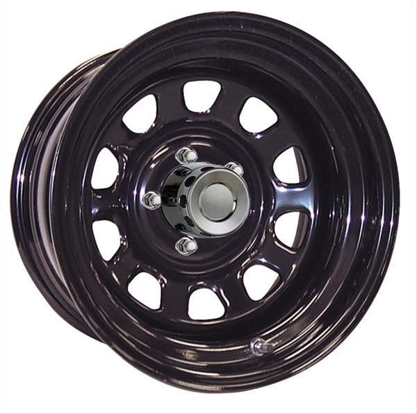

You can see the differences between a couple different steel wheels here: Been lurking, time to start contributing, here's my beater project got some FJ Cruiser steelies and some pro-comps mounted up with same tires for comparison. No spacers anywhere. The Toyota rims will likely be inset too far for what I would consider good looks on a flared rig. I transferred the pro-comps over to my flared rig (a 94) and they fit perfectly.

Steel wheels are not an upgrade from a forged alloy wheel that weighs half as much. A steel wheel can be beaten back into shape (sometimes it works) if badly damaged on the trail but unless you are doing some hardcore rock crawling this will not be an issue and happens rarely. My 93 oem wheels have taken a lot of beating on rocks over the past five years and have given me no problems.
Edit: 80 series stock wheels are cast not forged.
