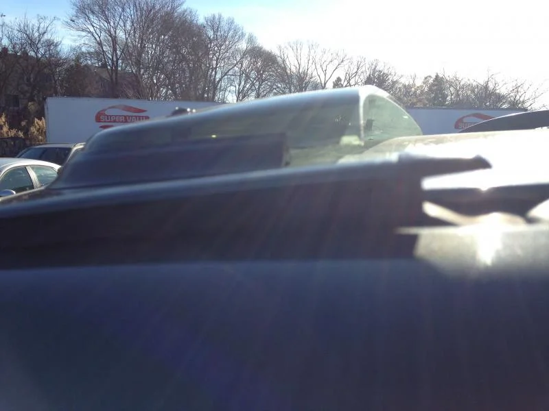

Ok, I just went and drove it again. Still like the car. I looked underneath and there's just a tiny bit of surface rust here and there. No visible leaks. It needed a jump start ( again ) so it definitely needs a battery. Took it out on the hiway, it runs nice and smooth, no odd noises from the engine.
Here are 2 new things I saw this time.
1. The molding that runs from the bottom of the windshield up to the roof rack on both sides is coming out at the top ( roof rack side ). I tried to push it or squeeze it back in but it didn't stay. The guy said it could probably be glued down. Fact or fiction. I posted a picture below.
2. There's a distinct whistle coming from the sunroof. And when you push up and down on the sunroof, it definitely has a little movement and you can hear the whistle change. We tried sliding it back and forth, but the whistle didn't change. The "tilt" feature didn't work, but I could live with that. But as silly as it sounds, the whistle would really bug me. It goes away if you close the panel, but still. Is this common or easy to adjust ?
Thanks for any feedback.
Oz

Part of the whistle could be coming from the popped up moulding and also the sunroof wind deflector. I will say that if that deflector isn't perfectly centered and secure, at about 70MPH with a slight cross wind, you'll get a heck of a scare with a loud vibration sound that sounds like the roof is coming off. I took mine off and found clearcoat failure under the rubber gasket.
I'd guess it's the sunroof visor too. I recently bought a window visor kit cause I like them on the windows. I ran the one on the roof for one day and took it off due to a nice whistle. I get more wind noise with the side ones too though, so if the truck has them and you like it quiet that could be your ticket to a bit more silence.
