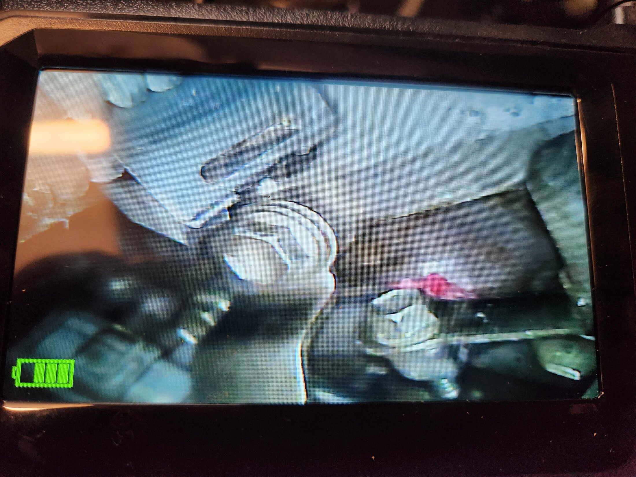

We'll, after about 1.5hrs of digging with my bore scope finally found 1 leak towards the back of the coolant plate. I'm sure there has to be more just can't seem to find them. My indy is scheduled to work on the plate for me (since time is an issue for me) this coming week. Just wanted to see the leak with my own eyes before having this job done.
Sorry for the low quality pic. Scope does not take still shots or video.
