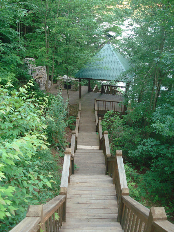

My families' lake house has a looong wooden staircase down to the water from the house. Currently, there is a run of PVC down these stairs so we have water at the grill/gazebo and on the dock.
The pvc looks bad and cracks every winter. (was very careful to drain before this past winter-still cracked).
We would like to replace with a semi-flexible black tubing/hose. The stuff they used to use for residential water mains came to mind.
Found Polyethylene tubing on Mcmaster w/ 3/4" ID for $0.28/ft. Item number 5180K77 . I was planning on purchasing whatever we end up with from a plumbing supplier, probably be cheaper.
Any suggestions would be great. This picture shows gives an idea of the situation.

D-Animal- that irrigation drip tube looks like it might be the ticket. Home Depot has the "Blue Stripe" Toro stuff for ~$.13 a foot, which is great. Claims it is at least relatively UV stable as well. Need to go check out their fittings. The line will only have 4 fittings- to a PVC line at the house, a junction at the gazebo for the spicket there, and a spicket at the bottom of the stairs which is just out of sight in the picture.

i've been closing up and draining a beach house here in new york for 35 years and i can tell you what the problem is.....you will always get broken pipes if u have to blow them out . pipes need to be able to be drained by gravity...period. no matter how much u blow them out, or what they're made of, if they aren't pitched properly, some water is gonna pool in them and crack them somewhere. looking at that stairway, seems to me u might wanna put a tee and a valve pointing down at some of those landings....anywhere the water could puddle inside the pipes. costs more, takes more time to do it...but it WILL work. and if u intend to have the house in the family for a loooong time....might be worth it to just do it in copper. copper is a 50 year fix, and it can handle any house water pressure u give it.
