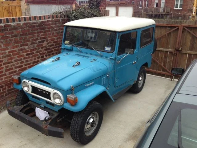

Hello everyone,

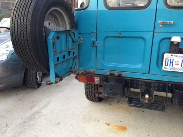

I'm looking to get some opinions from you guys on this FJ40. It's a '76 and is proclaimed to be completely unmolested. I don't have a trained eye for 40s so any info would be appreciated. The one thing I did see was the spare tire carrier seems to be the '75 and earlier version but the seller has confirmed this is a '76.

I believe the tire carrier changed in mid '76.

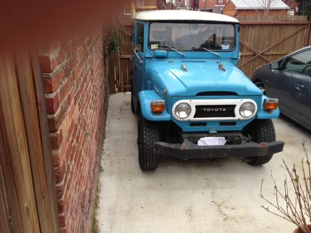

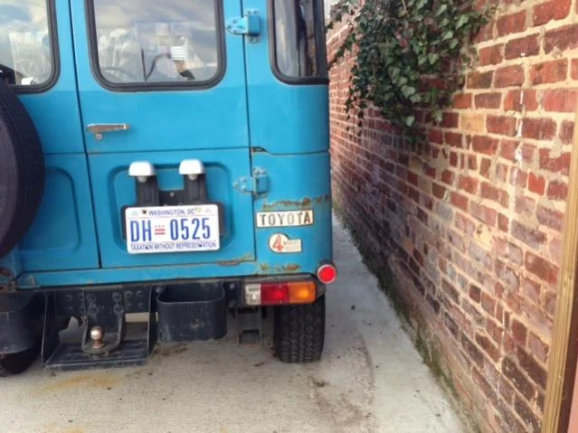

I found the CL ad and that is not "superficial rust" as the owner would have you believe. You probably already know that. Just looking at the long shot pictures you posted of the rust, that are not in the CL ad... Front bumper is mangled. The rear corners and sill are full of rust. You can see on the driver side behind the door is already rusted through, and there is something funky about the black driver side step, along with the black at the top of the driver door. It looks like there may be rust in the rain gutter, but hard to tell from the long shot pic. There is rust under the passenger side turn signal assembly. The front engine hook is terribly bent for some strange reason. It appears to be smogged, which is good.
He is using photos in the CL ad possibly from the previous owner. Note the MD tag and now it is registered in DC based on your pictures. So if he is the second owner, and the truck is from CA, did he previously live in MD and move to DC recently? He also did not put any pictures of the rust areas in the CL ad. Based on the misleading pictures and "superficial rust" statement, make sure you thoroughly inspect the truck. Ask him to please make sure not to start the engine prior to your arrival for inspection. You want it stone cold.
Even with all the negative I just pointed out. The truck appears to have the jack under the driver seat. It looks like the factory tool bag next to it. Hopefully full of all the factory tools. It has the jump seats along with the center console and factory floor mats. Looks like the dash has been cut for a radio and a tach, but I personally don't consider those so bad. The knobs are there and look to be in good condition. He will probably be able to easily get 9K in this area for that truck. If you fixed all the rust you would have a very nice 76. Or you could put it on eBay or one of the auctions and probably easily double your money if you fixed the rust.
Not sure what your plans are, but that appears to be a very solid truck for this rusty area, and would be a great candidate to fix the rust and, keep and drive forever. IMHO
