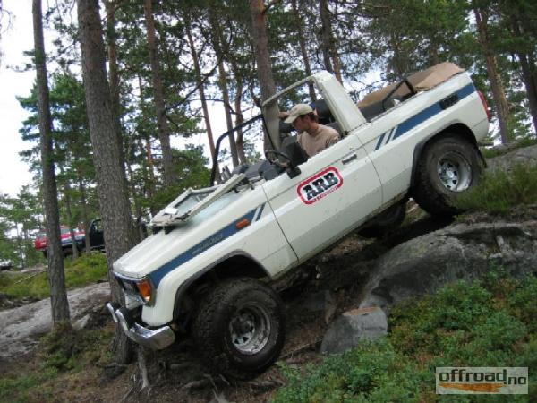

The soft top is made of thick PVC or something like it. The inside is more soft fabric. The windows are also thick and welded to the top. It got an area in front with double layer to reduce noise.
A plate is screwed to the windshield top. the gap in the front is for hocking up the canvas. On each side of the trunk a folded sheet metal plate are screwed with the same holes as the FRP top. The brackets for the "U-bars" are connected on these (see the photos). Both U bars got adjustable heights. The rear U-bar got a "knee" to stretch the top. The original half back doors got a rubber lip on the top (after removing the windows). On these U-profiles is fitted. On the roll bar a Velcro is glued. All the way round the tube snap button are used to connect the top. The same are for the cover. The front door window top squeezes a lip on the top. When removing the Window frame, none connection. When the cover is on, it look like a sports scar spoiler and you can open the rear doors.
+ Not much noise
+ Very good quality
+ Few piercing in the chassis
- Stiff and hard to roll up side windows (should be removable with zippers)
- White inside fabric get dirty
- Difficult to fold down to fit the cover (I drive without cover)
- The top is not so fast and easy to fold as a sport scar top. It depends how tight you want it.
Here is also a soft top manufactured in Germany. He bought it used by Bushtaxi.de. A very nice solution!
http://offroad.no/snitz/topic.asp?TOPIC_ID=3539&whichpage=2&SearchTerms=kjetila
