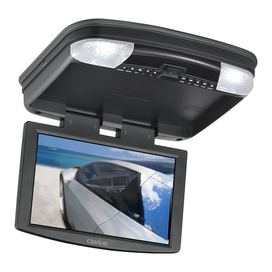

Mine seems more simple...all right at the unit. it's a Clarion.

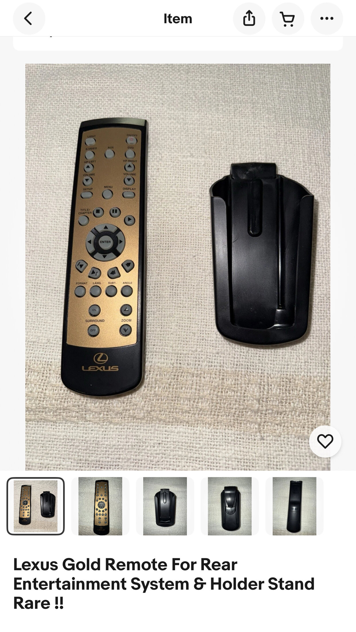

Is this the remote you guys looking for ? Im looking for another one but hope this helps. Saw the post but no part numbers.
