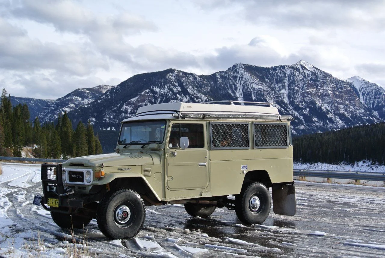

How high is the inside of the roof of an HJ61 high roof? How many inches from
floor to inside of roof? Not the door opening, rear floor where the floor is highest,
and roof is highest.
I know it’s 5” lower floor right behind the seats.
standard 60 is 41”
BJ74 is 46”
what’s the FJ/BJ40?
Standard 60 is 1050 mm
Troopy is 1250 mm
BJ74 is 1175 mm

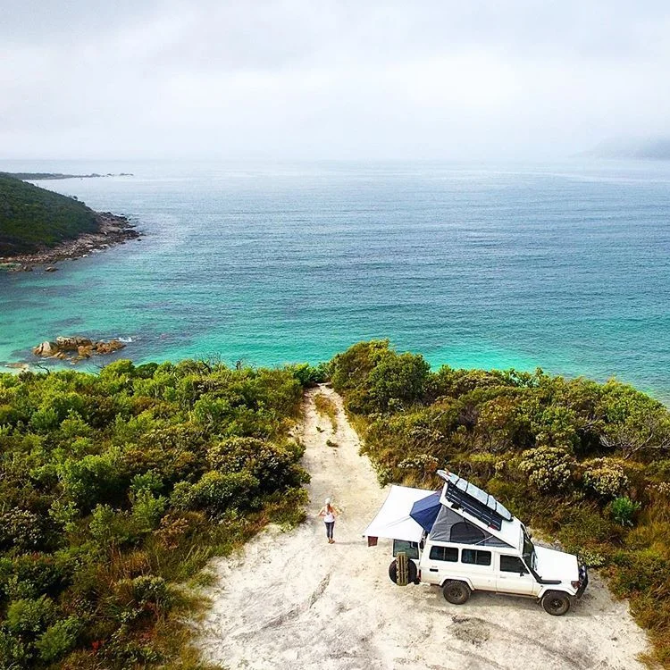

sounds like you need a pop top
I definitely don’t want some front tilt thing. I’ve worked on a mechanism for lifting
straight up. Probably be happy with a raised hard top. I’ve seen all the pictures there
are to see. The guy who bought the Campteq plans wants $8K just for the two
pieces of aluminum. For that much, No.
