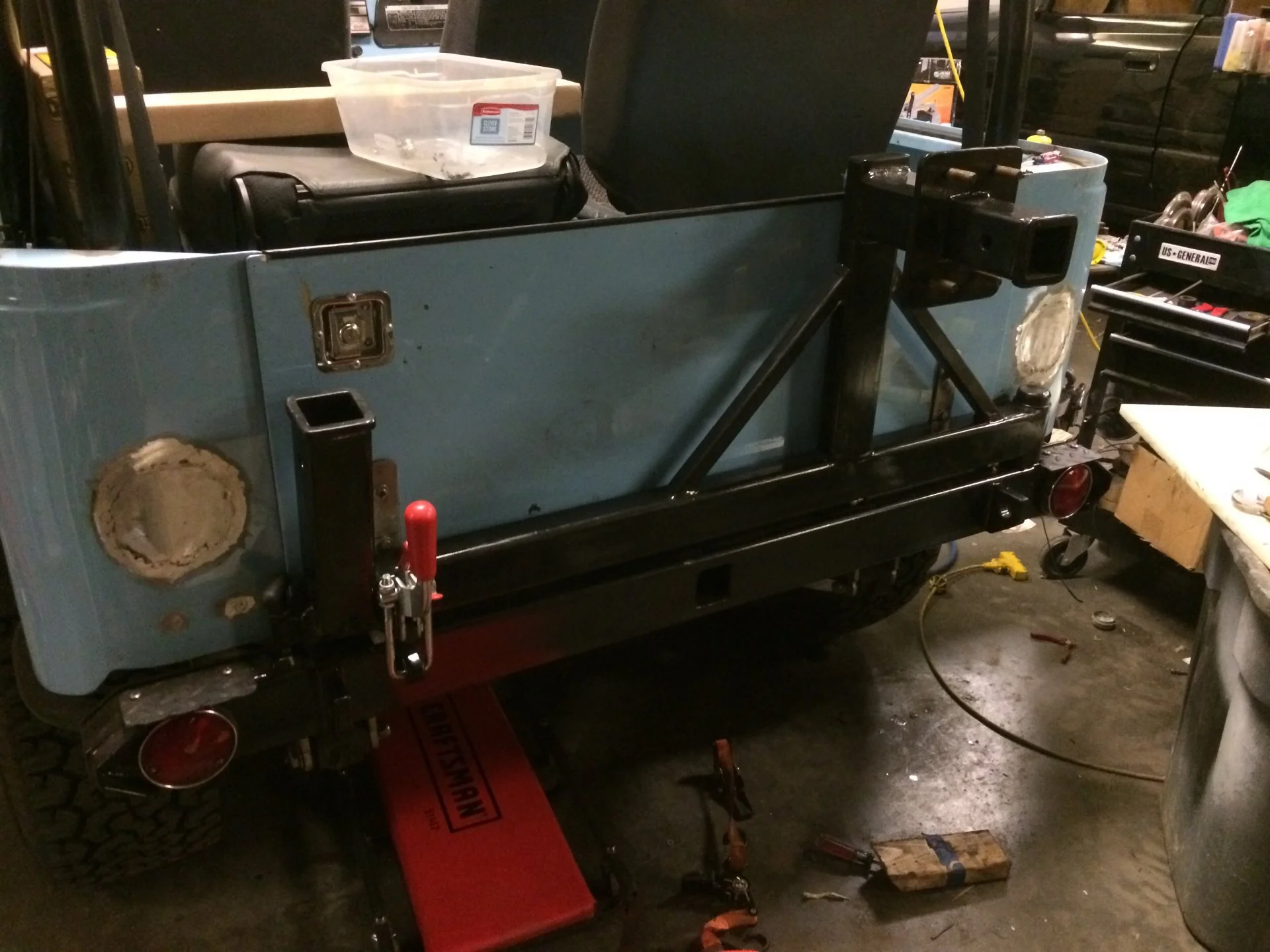

Gladly hand u parts and you can figure it out! I'm so happy you are ahead of me on this build! I have some very heavy boxes of stuff here at the house , and don't forget valleytech is local and builds bumpers. Honestly, I have 2 types of spindles here, oil impregnated bronze bushings and roller bearing style. Prob arms for both. A cooler carrier etc. Your welcome to come have a look. Or draw up what your thinking and we can noodle on it or take the plans and to Garret. Or u start chopping and welding. I can flip the 40 around and use it as a template. Getting ready to chop the rear of the frame of anyway. Would give you a rear xmember to use to mock up stuff. And /or give it to Garret as a base to mock with.
I custom made mine, Pretty simple really.
