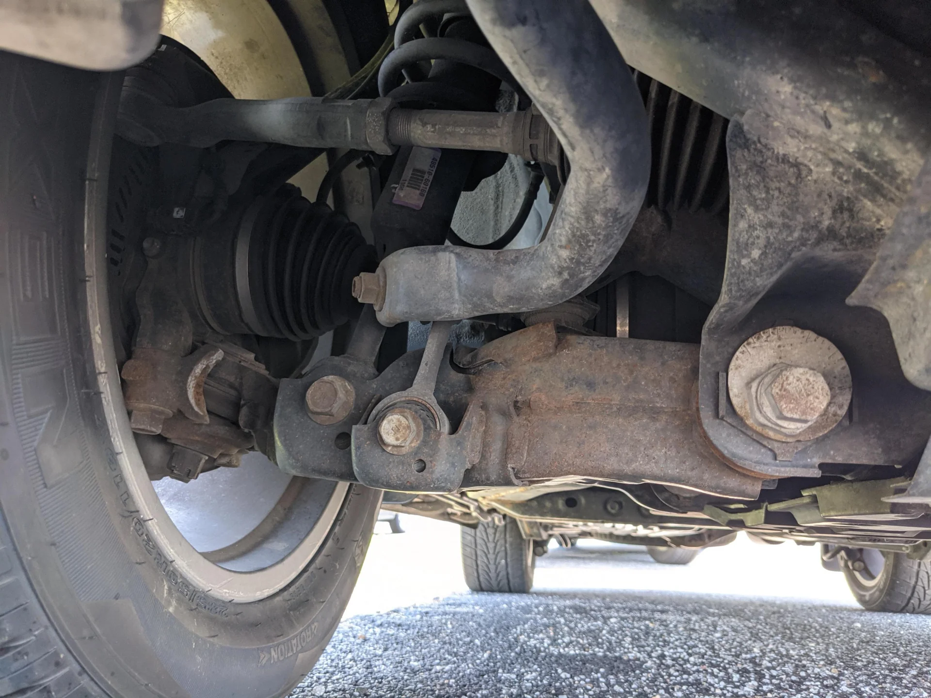

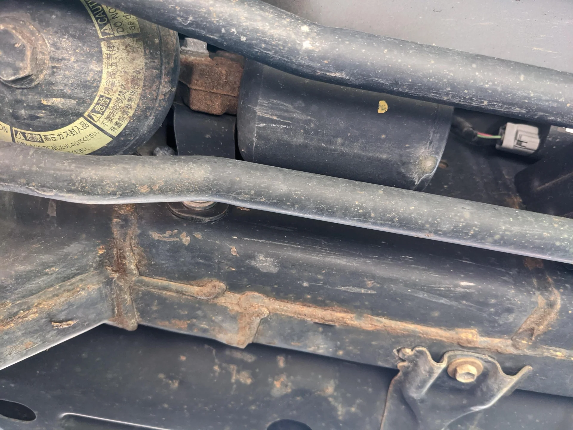

Thanks for the input everyone. I am pretty sure I am going to pass on this one. I did stop and take a few photos for you guys of the rust. I assume I can find one with less if I look further south. I am pretty much looking at all the southern states right now. I don't think I want anything from the KC area, they get a fair amount of snow and then top it off with salt. This LX will be replacing a toyota I have had for 15 years and I expect to keep this 200 for at least that long, so I want to get it right. I am in no hurry.

That rust isn't terrible. ...But why settle?

Fifteen years is a long time for what is in the pictures to progress. Sure, much of what is visible can be treated, but there are hundreds of fasteners that have started rusting and will be a game of Russian roulette any time you need to loosen anything for maintenance in the future.
You are right. That said, I bought a pretty darn crusty 2001 land cruiser, drove it for 3 years with zero issues, and then sold it for 500 more than I paid. This happened in 2018 before land cruisers got stupid. That 8k truck I sold in now worth $15k. That truck had a lot more rot than this one. Imo a rusty truck will stop rusting in a sunbelt state. My .02.
Undercarriage rust looks near negligible if you're the type of guy to keep up with it in the future. But what about the body? Any rust in the pinch welds, rockers, seams? If so, then hard pass. If not, then just make sure you pay a price that reflects the overall state of "meh" for this particular vehicle.
