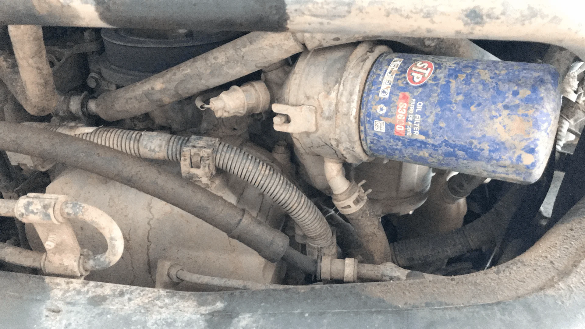

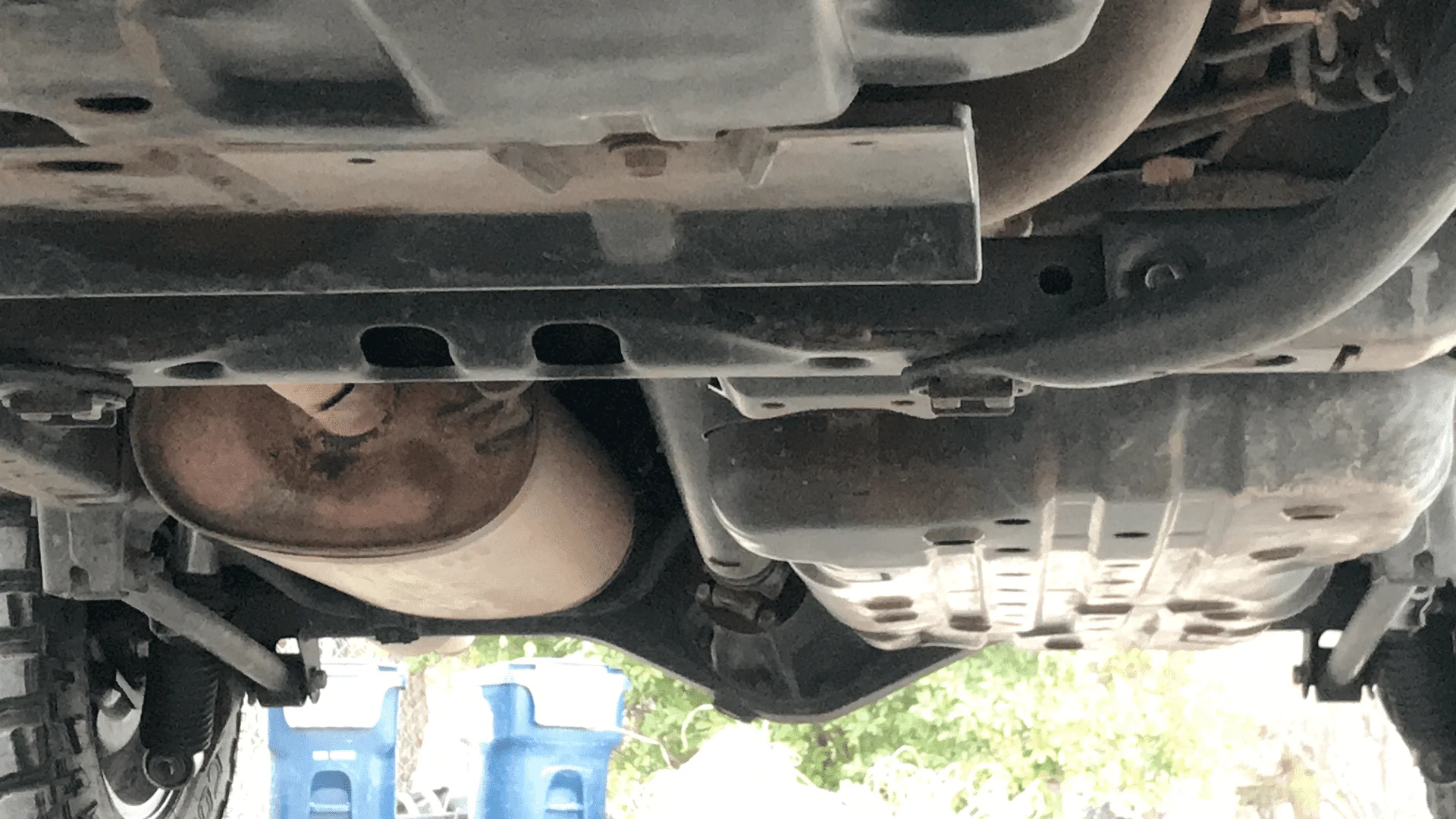

What are some of the common issues I should be looking at or for?
From the pictures I have seen the frame appears to be rust-free, AZ car its whole life.
