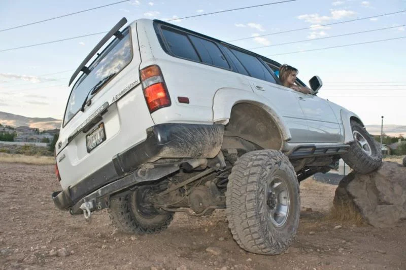

The 80 has some flex! Little fun up Hunter Lake
Not bad for a truck with OME 2.5" mediums, 7100's, and the rear sway bar still attached. :eek:

Rig's looking good. By the way, unhooking the rear sway bar doesn't add a whole lot more flex. Most say that keeping it hooked up "balances" the suspension more.

That's what I've heard from others on here. Makes the front do a little work too. I'm pretty happy considering how little I really have done to the suspension!
