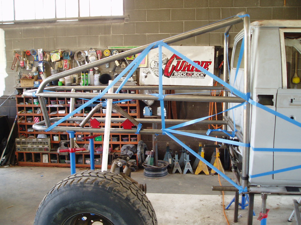

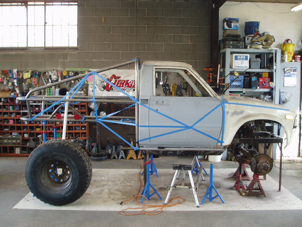

I got a little done today on the truggy. The main hoop is fit and two main cross members as well. I use the blue tape to get a visual on where the cross members are going. ALso made up two taller adjustable stands that will support the rear most part of the back half while being constructed.
I managed to get a little time today and got the main HOZ hoop bent and in. Not much but a bit. You can see the new stands in the photos, they allow for precise adjustment.
I got to work on the Truggy again this afternoon. The upper hoop is tacked in with the two rear vert tubes. Also got one upper tube in. Starting to feel like a truck again. I gan get a feel for where and how I can hang the rear fenders.

I used a random piece of tube in the shop to use as a shock hoop. The final shock hoop will be taller and the front leg will land on that lower node toward the cab. It will be a mix of 1.75" and 1.50" tube. If you look close on the PVC pipe there are two red lines, proposed shock mounting heigts.
The back end is basically a 3 bar triangulated truss on each side tied side to side at several points. There will also be a second B hoop inside the cab along with A Piller and Halo. The exo is to protect the cab, interior to protect occupants. Everything you see on the cab will be interior. The two B hoops will be connected through the top and as sceen.
The back half is starting to come together, no more tape :)
