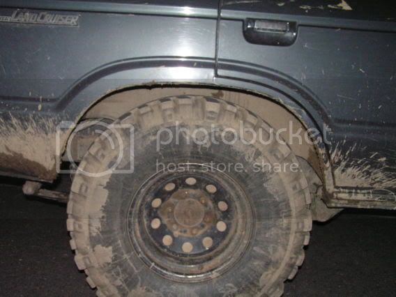

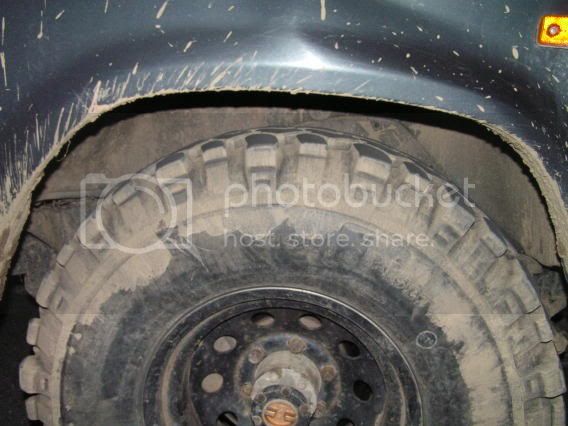

Look mom no lift clearing 34s
Post up a picture of those springs... u sure there's not an add-a-leaf in there? My worn out 34's rubbed like CRAZY on my stockish sprinsg with add-a-leafs... and the tires only measured to 32" when I pulled them off.
Chris
Chris
What was thw with of your 33s? My 34s are 10/50s
I took 32 11/50s off that didnt rub at all. only reason i think they fit is due to haveing proper backspaceing and the narro 10 and a half inch tread.
:cheers:
33 12.50's seam to work OK arround town on stock rims (they do crown) I am pretty sure they are gonna rub in deep articulation but this one will not see much of that. BFG At ko's in the front, MT Baja claw in the back, BFG MT for a spare, all used castoff froma friends CJ7 when he went with 37's.
my fenders already have built in clearance from rust
