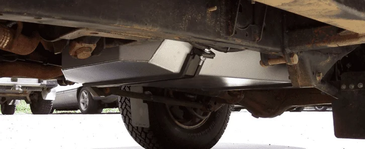

Bit of a cross post from some other threads, but Cruiser Brothers is now exclusive US agent for Long Range Automotive.
Photos below for the 40 gallon replacement in the 100 Series - $1,595
We also have aux tanks at 42 and 24 gallons. Our kits are complete and work with US emissions.
See the video and give us a call - thanks!

upload_2018-5-15_7-54-28-png.1701221
upload_2018-5-15_7-56-27-png.1701223
upload_2018-5-15_7-57-9-png.1701224

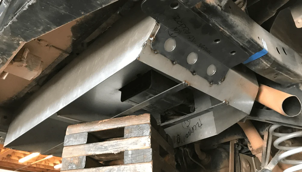

Not quite ready for prime time. The test tank is shipping from Melbourne next week and we will have 40 and 24 aux tanks for all 100 Series (early and late) late Summer. We needed to notch the tops to clear charcoal can.
Process is time consuming but straightforward - cut/mod tank and adjust the fill tube connections to suit.
Here is GX 470 tank in development. 100 looks similar.

Im curious how you're going to work around the resonator that runs along the rear pass frame rail. Looks like it has been cut off on the GX photo above. Is that likely to be a requirement for the 100 series?
TBD but some kits require exhaust modifications.
