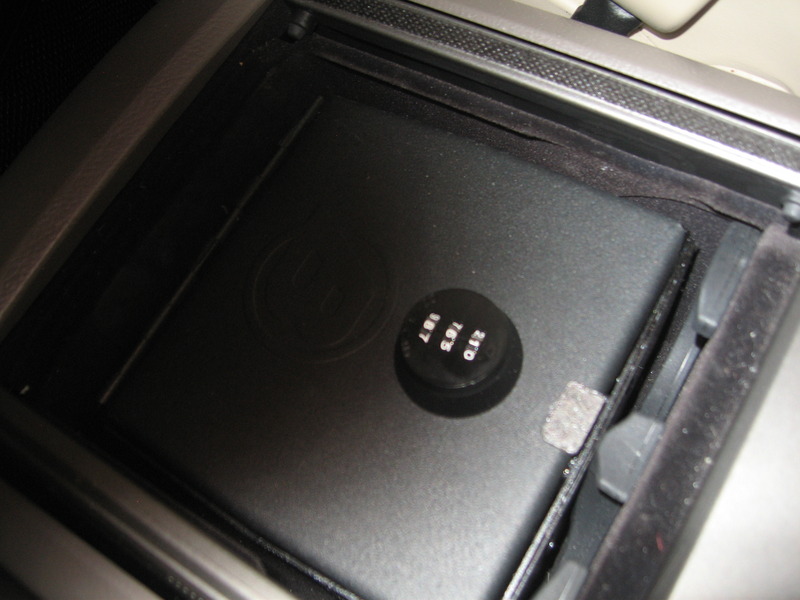

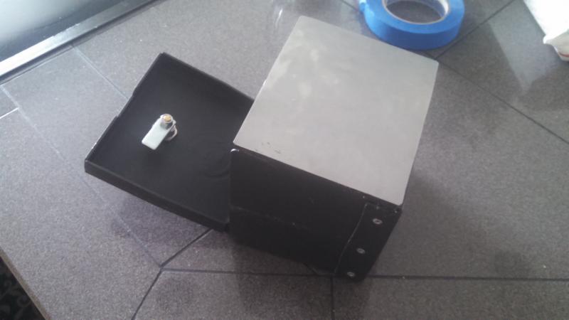

The first thing I did was measure out 2.75 inches to remove and marked it with masking tape. The box has a complex tapered shape, so I had to remove the 2.75 inches from the middle, starting an inch up from the bottom. I used a reciprocating saw with a metal-cutting blade and it went fairly quickly. You'll notice that the box is almost 9 inches and I needed it less than 5.5 inches, but I only cut out 2.75 inches. The reason for this is that once I cut out the middle, I needed the top and bottom pieces to overlap so I could re-join them. With the overlap, the box stands just under 5.25 inches. I intend to upgrade the lock, so I left a quarter inch more room to add a combination lock.

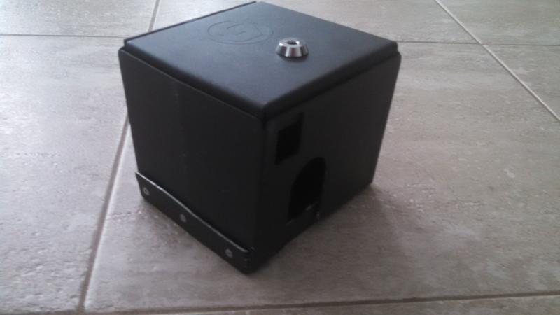

Once cut, the top piece is slightly larger than the bottom when measured front to back, and they are the same size in width. I slotted the corners and expanded the bottom slightly so the bottom sides would fit outside the top when put together. Since I don't have a welder, I used rivets to re-attach the pieces.
In the photo above you see the two pieces re-joined with rivets. You also see the large holes in the front where the Jeep console outlets would go. We don't need those holes, so I took some sheet metal and cut it to fit. I attached the metal panel to the front of the box using JB Weld and a few rivets.

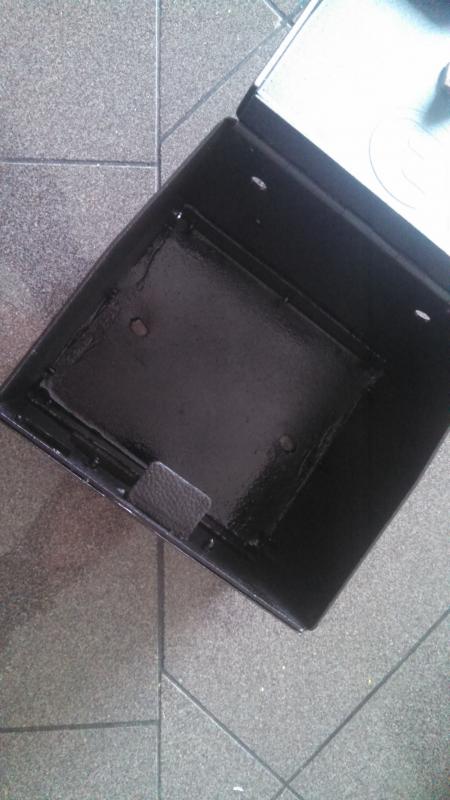

I measured out the spacing for the mounting holes, using the stock mounting holes for the console as a template. I bought some new, 1/2" longer bolts at Ace and some washers. You'll see the bolt holes in the bottom photo, and you'll also see that I added a small piece of leather on the lock mechanism to keep the door from clanking when going over bumps.

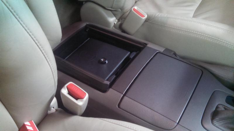

Once the paint was dry, it could be installed.
I figure the biggest vulnerability of this box would be someone prying the front open where the lock cam is located. Therefore I installed it right up against the cup holder mount to make it harder to pry that part open.
