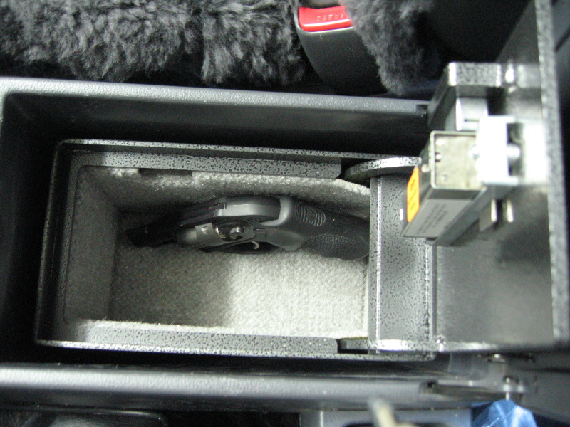

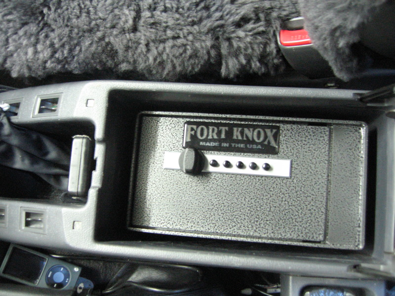

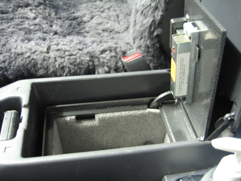

Found that the Ft Knox Auto Pistol Safe is just about exactly the dimensions of the center console in my 1995 LC.
I bought one and installed it by drilling 2 holes in the bottom, then using longer bolts (M8x1.25 x 40mm) to secure it through the original console holes. It's bolted in tight to the metal body.
Yes, someone could still conceivably pry it loose from its mounting points, but it would take them some time to get it out, and then they would have to work on getting the safe itself open. Nothing is perfect, but this should stop the run of the mill smash-and-grab type thieves.
EDIT- Added 2 more bolts through the bottom and into the body of the truck. 4 bolts total now. That sucker is in there tight.
Update - The buttons on the simplex lock tend to jiggle and rattle over bumps, so I took the face plate off and put a thin piece of low density foam around the buttons. I also added a thin piece of foam tape where the lock bolt touches the door frame. All quiet now.

I know you're just teasing, but to be clear I have no fantasy of drawing from the safe in an emergency. The safe is for securing valuables and does not replace my holster (unless I'm in a place I can't carry). Nor does it mean I can relax my awareness of my surroundings.

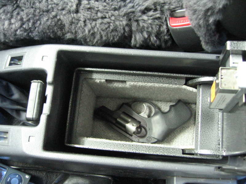

The safe is 6" deep, 9.5" long, and 5 " wide. The interior padding takes away about 1" from each dimension. I found dimensions for the G23 at roughly 7x5".
G23 should easily fit, but may not lie totally flat on its side.
The LCR pictured is 4.5 x 6.5".
