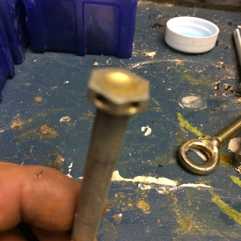

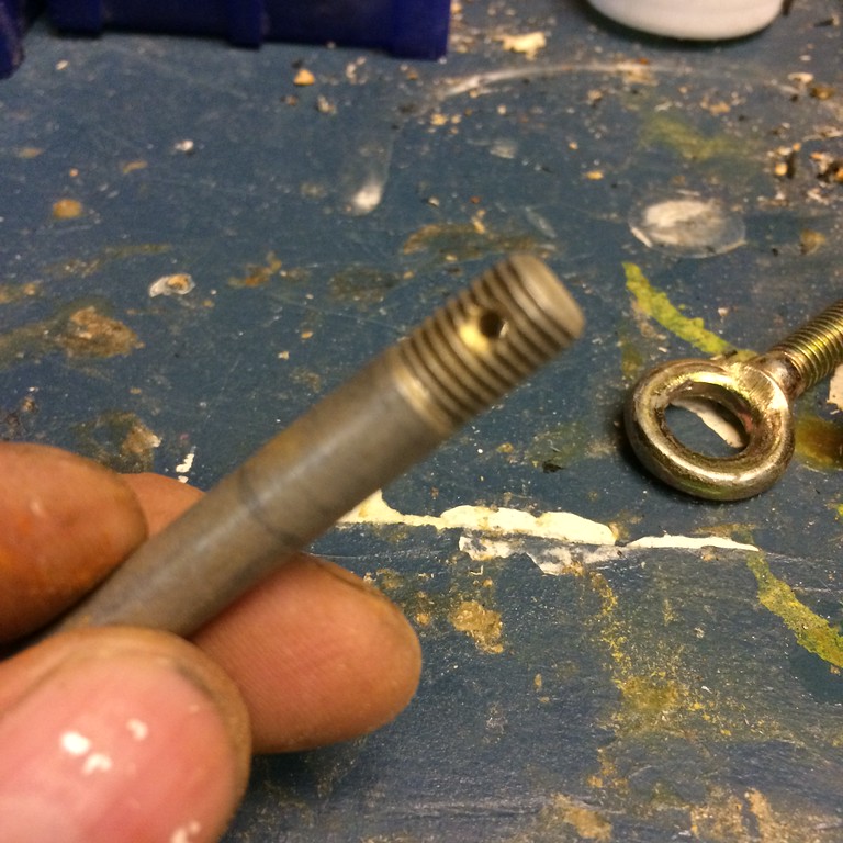

Hopefully you get the idea of how well made this fasteners are, a insertion hole on each facet of the bolt..
And then a "Cutter pin" Castle nut, just in case, no joke, all body, almost no treads (basically Straight body is much stronger), very, very expensive to keep a inventory of so many sizes and lengths.
