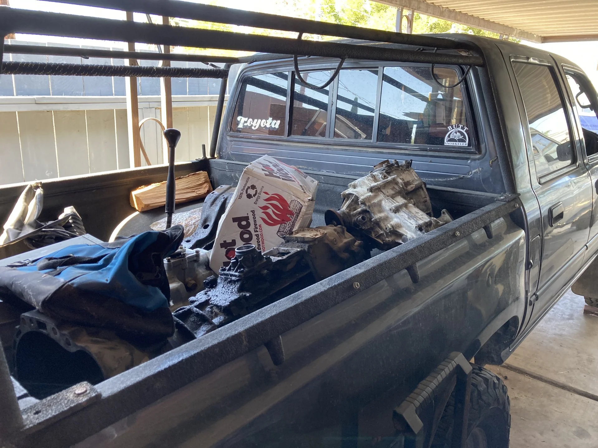

Was going up a hill in second gear, got to the peak and put her in 3rd not rough and then big snap and 3rd gear gone. Have every other gear still working. Drove it home in 2nd. When in neutral it sounds like something is flopping around in there. Just wanna know what people have got to say. I have it out and am going to open it up and see what's happening in there.

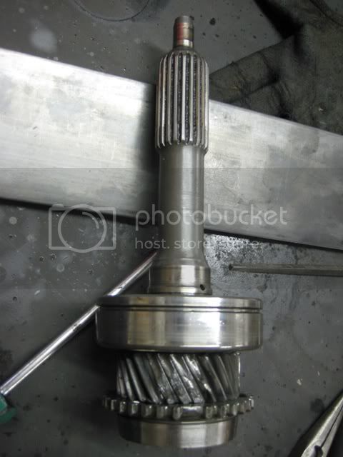

The G52 and G54 are both known to be pretty weak internally. They were also used in Jeeps behind the 2.5L as the AX5 so you’ll see replacement parts listed for both the AX5 and G series.
Some G series links I’ve collected:
AX5/G54 Hybrid Transmission - AKA how to run a Toyota... - https://www.pirate4x4.com/threads/ax5-g54-hybrid-transmission-aka-how-to-run-a-toyota-t-case-in-your-jeep.1004043/
G52 Input shaft bearing - https://www.pirate4x4.com/threads/g52-input-shaft-bearing.700194/
