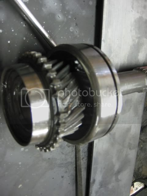

#3 son's '84 truck w/ 225,000 miles started making a rhythmic knocking , at first only in 5th gear but soon after in all gears, varying with rpm. Towed it home, pulled the tranny, and found this:
Four teeth in a row on the input shaft main gear sheared clean off! I have been driving and wrenching on Toyota trucks for 19 years and have never seen anything like it. #3 son is hard on vehicles (that's why he's still driving the '84 with high miles :) ) but he could pin-point any episode that would have constituted transmission abuse.
Amazingly, found all necessary parts to rebuild the tranny semi-locally (next county) and in stock at a transmission parts house. New input shaft (main gear an integral, permanent part) $99.80, new countershaft with all gears (countershaft gear corresponding to the broken gear on the input shaft had a few nicks in it) $150.00, and a bearing/seal/gasket kit $89.58. Pretty much a new transmission for $360 and some sweat equity.
I have built several motorcycle transmissions back when I used to make a living as a bike mechanic, but this is the first Toyota transmission I have ever had apart. Rebuild was not incredibly difficult with the factory service manual and a shop press. Take your time, follow the FSM with exactness (#3 son discovered this the hard way, I made hime do all the real work :D ), pay attention to how the synchronizers fit and work, pay attention to the order and size of the detent balls and springs on the shift fork rods. Be careful to set up the thrust spacing correctly on the output shaft.

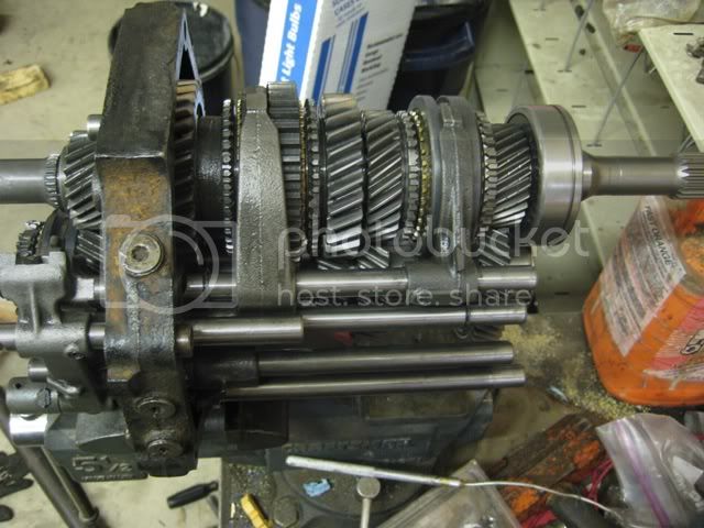

Finished tranny, ready to go back in the case:
Yup, it's easier to do that you'd think.
