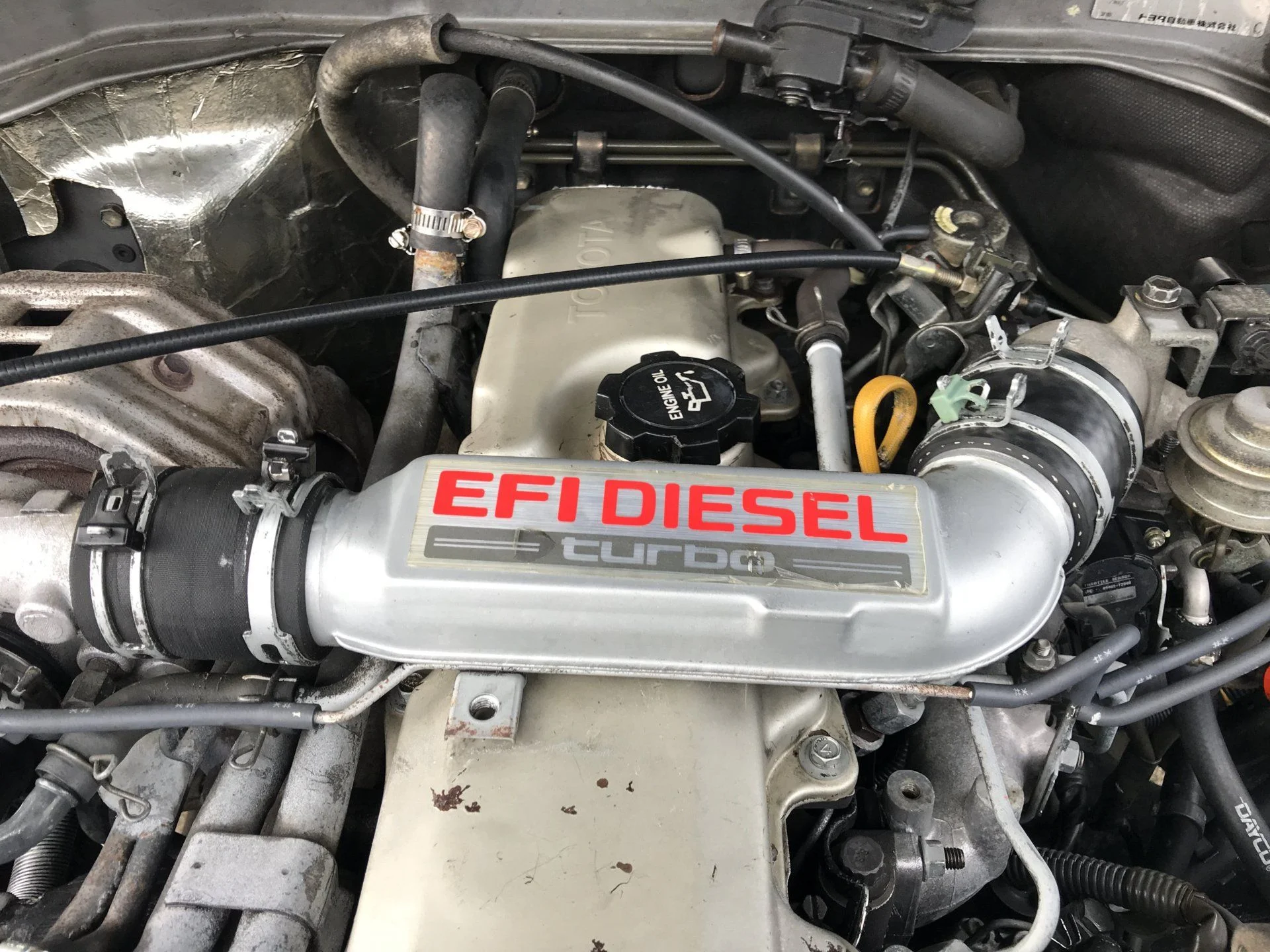

Took the Prado in for its birthday service as wanted to be sure I wasn’t missing anything.
Turns out both the hose parts to and from the turbo needed replacing.

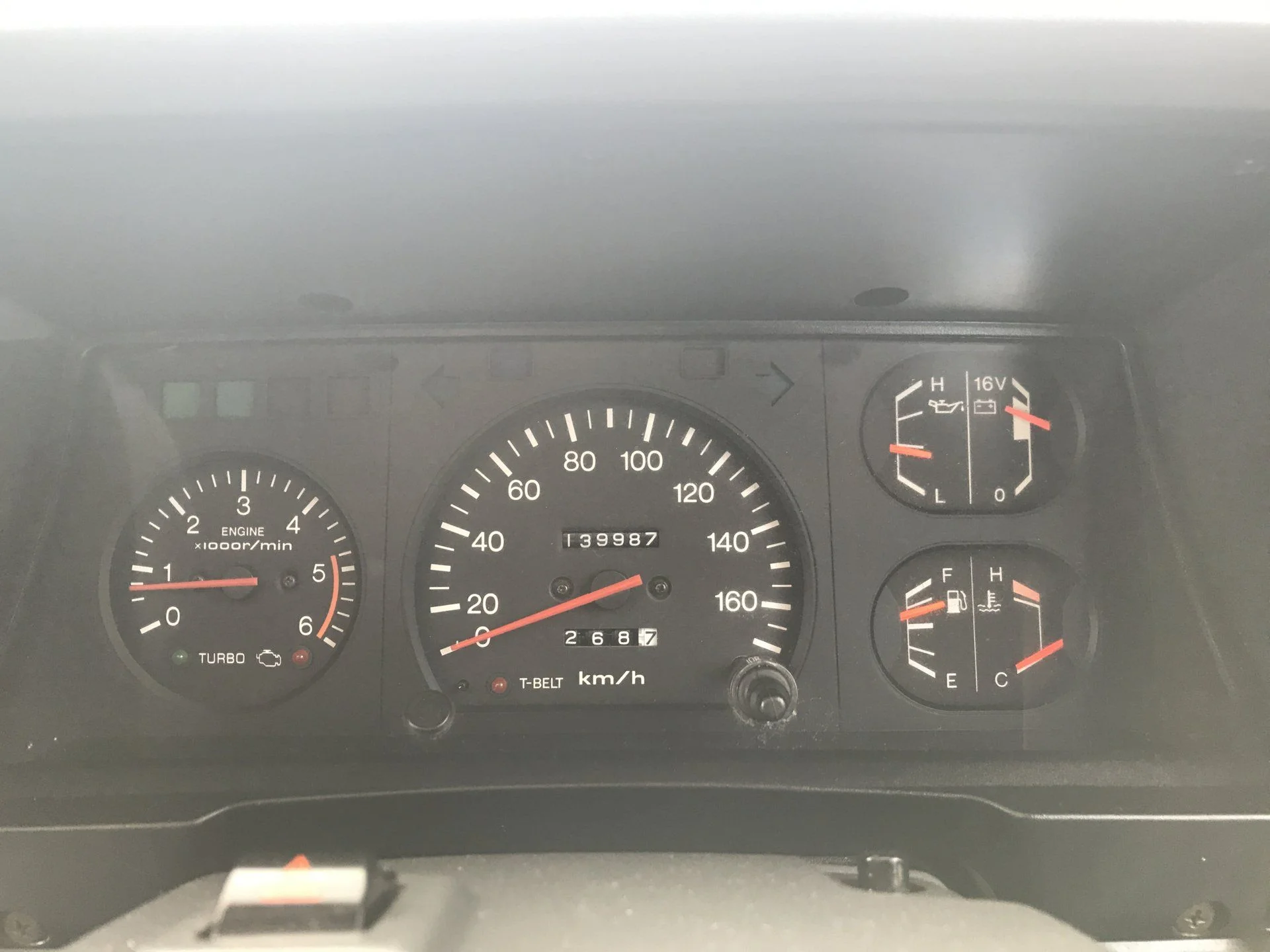

Good to have the peace of mind that’s it’s all reasonably sorted now. The temp gauge is still sitting a little low though. Pic taken after 15 mins of driving below.
