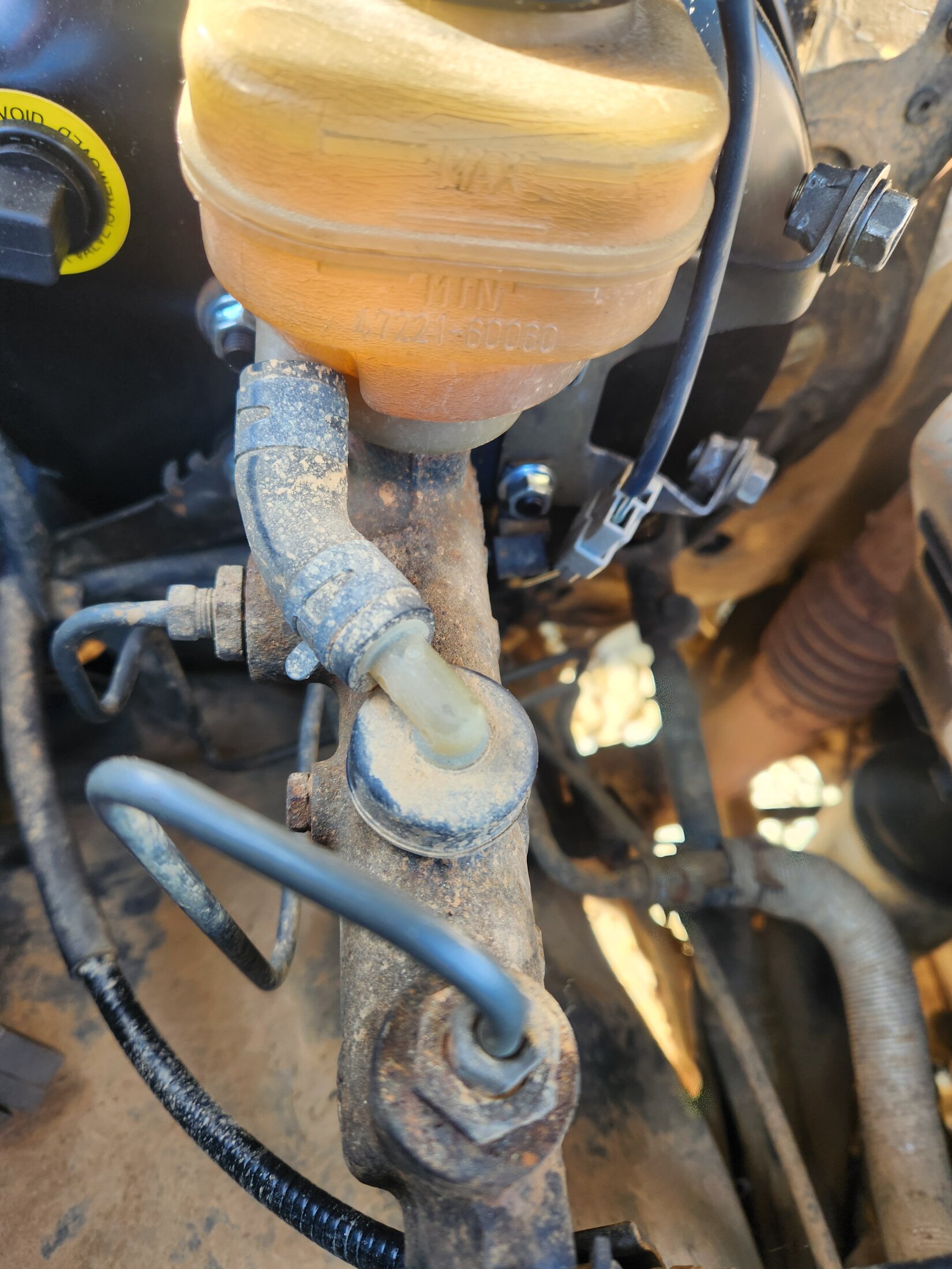

I have a 1991 LJ78 (JDM) truck with brake issues. Pedal went to the floor, so we bled the system several times with no change. New booster and not much change. It will lock up, but still a dead feeling pedal. Looking for a master rebuild kit. Anyone have a source? No signs of leaking when replacing the booster. But there is also a vacuum reservoir assembly, but I have never seen/dealt with one of those.

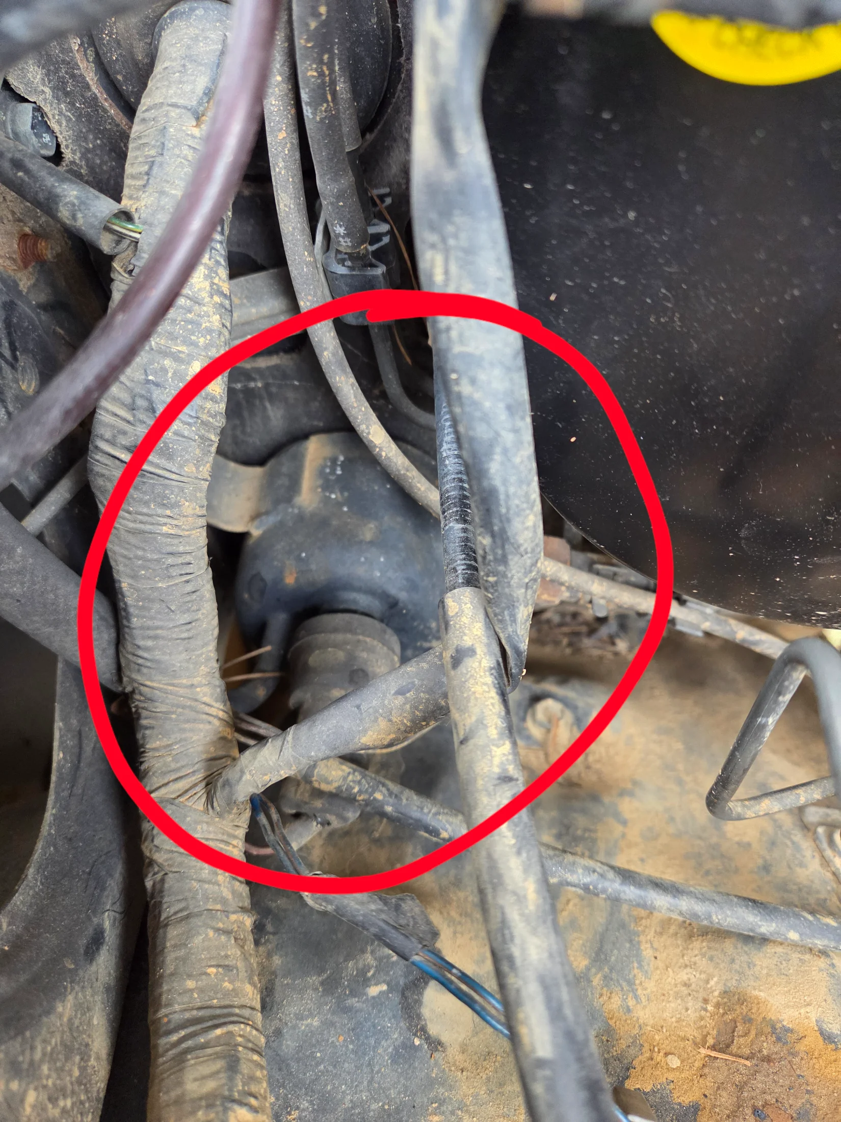

I am still trying to track down the brakes on this truck. I've replaced pretty much everything - master, booster, load valve on rear axle, bled brakes numerous times. The only thing I haven't touched is the vacuum reservoir assembly - P/N 4474060090. I am not seeing it available anywhere. Any other options? Thank you in advance .
If the vacuum reservoir is leaking, hitting the brakes should feel pushing against a brick wall.
No vac in reservoir means the booster is not helping you push.
Any vacuum reservoir can be used but the original probably has a switch on it that triggers the dash light to tell you you have no vacuum built up.
If your reservoir is a steel can like mine you could repair it.

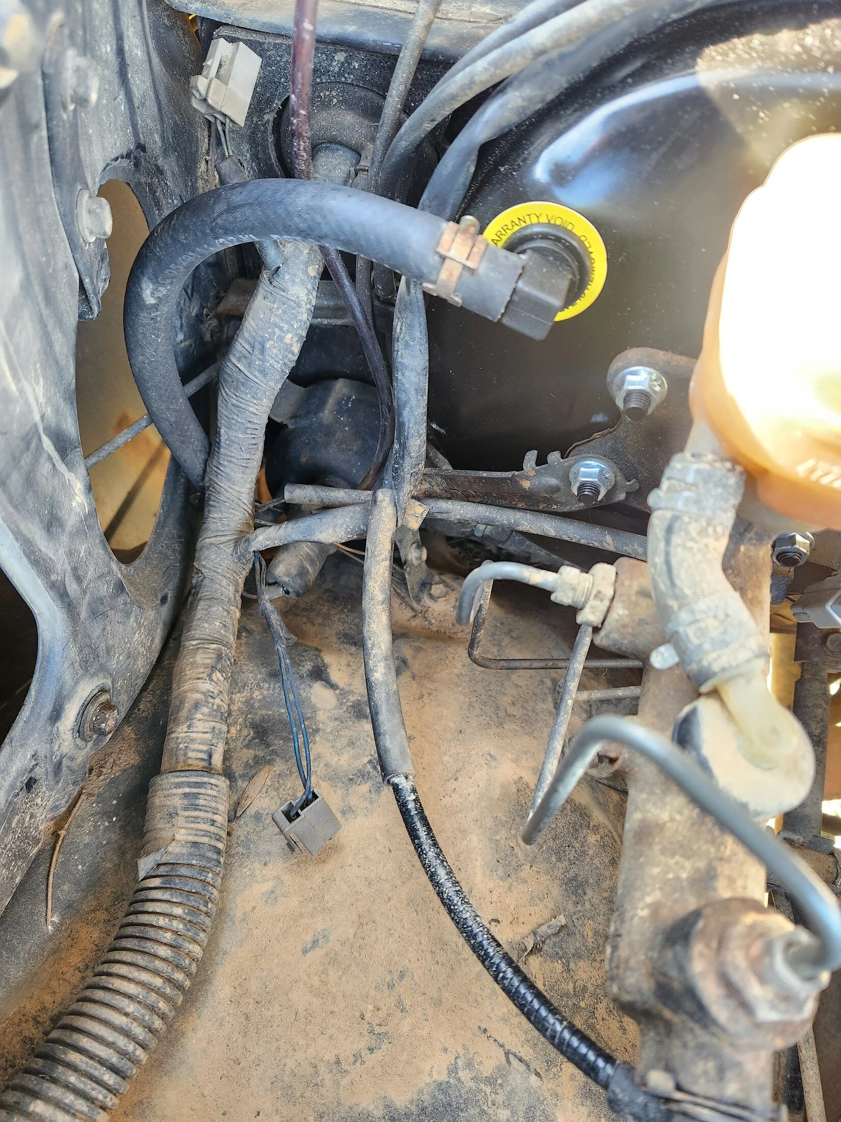

Mine appears to be the original, as shown in the picture. But the pedal is quite hard with little movement. The reservoir is the only thing left, so it seems as though it might be the last option. I will likely bleed one more time. This truck is used in my fleet for military off road driver training, so it sees a lot of trail use quite often. The calipers are relatively new as well.

Tee a vacuum gauge into the line running to the reservoir to see if it holds vacuum. Alternately, hook a hand vacuum pump to the reservoir and see if you can pull a vacuum on it, then see if you get at least one good pump out of the pedal.
