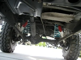

Hi guys,
I am writing on behalf of a friend with an LJ70 (3 door). I have no idea about this car and as it is rare in our country (Greece), sharing your experiences will be appreciated.

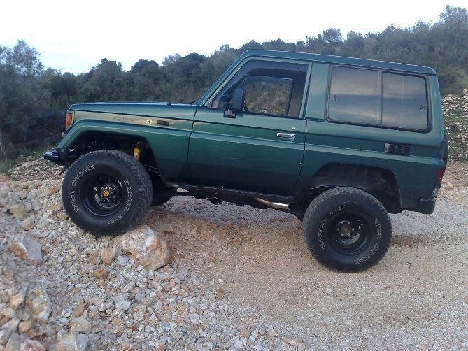

The current setup includes 33" tires (15 " rim), 2" OME suspension and a 3" body lift.
The target is to increase articulation as much as possible (reliability should not be sacrificed).
Is there any A bar link kit or bush kit to increase articulation??
Pls provide your thoughts/ideas, including cost estimates and potential sources of material.
Thanks
Christopher
This is how the rig looks now ...
side photo here ...

I am following this one as well, mine is a KZJ70 the same should apply.
Most people on here have leaf sprung cruisers where as the LJ is coil sprung all round.
You can remove the sway bar/s to gain some extra drop on the axle, but I am not sure what that will do to normal highway driving?
I guess you will have extend the brake lines, which is fairly simple job and also maybe compensate with longer shocks/ springs.
You could maybe to do a Spring over Axle configuration, but I am just assuming...anyone with experience please tell how we can increase the articulation and what the downsides are?

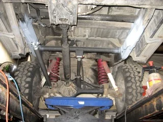

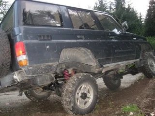

I have a lj 78 that has almost the same coil sprung suspension as your lj70. Your right that the stock suspension can't even flex over a speed bump. The leading/trailing arm set up rides so smooth but dosn't flex. I used Dobinsons 4 inch lift coils and extended everything to fit and gained about four more inches of flex from stock. This was not good enough. The next move was to three link the rear. I went from 8 inches of wheel travel to 15 this worked very well. After a while The Dobinson coils leaned to the left bad and the front was always 1 inch lower then the front. Next was six inch lift coils from Rabbit Auto I brought back in my suite case from Japan. I now have around 17 inches of wheel travel with longer shocks.
This all took lots of welding, steel and planing. The front suspension still dosen't flex well. I will three link the front soon.
