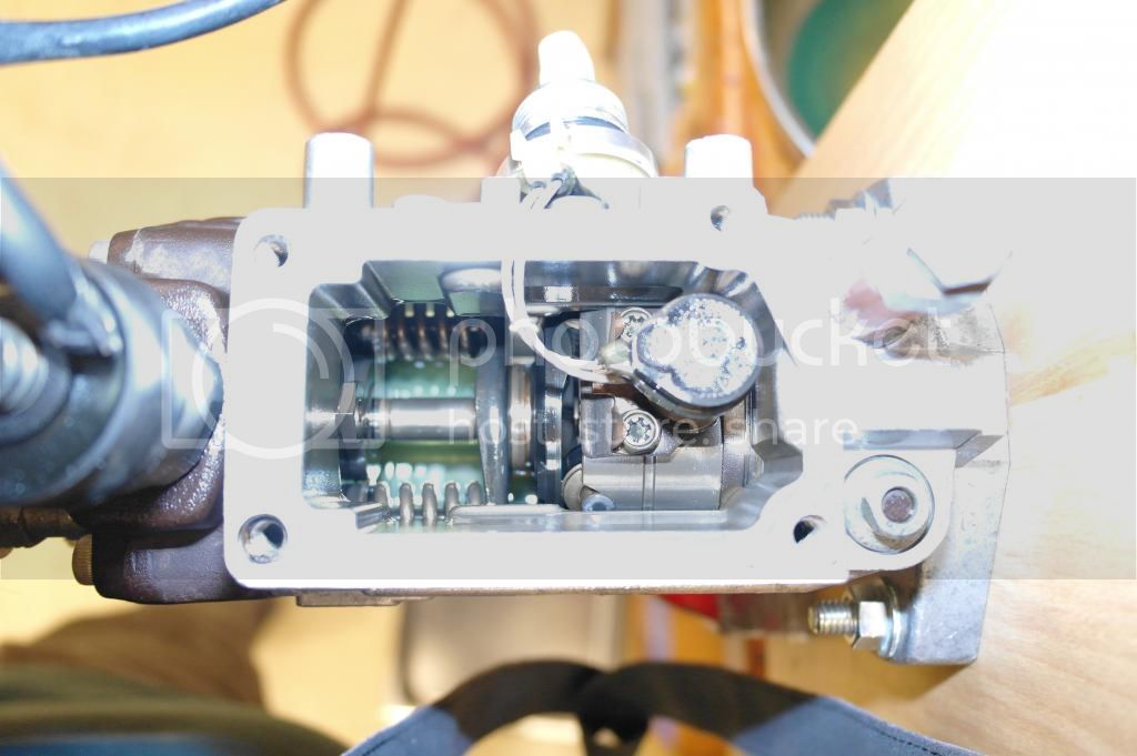

A few members on here have helped me a lot with this issue and brought up the idea of me possibly messing up the fuel pump timing. If this is the case Im fairly certain I may need a new fuel pump
You haven't mentioned where you are. But before you splash out on a new pump, it would be highly unlikely you need a new pump because of you messing with the fuel pump timing.
With all the good intentions of your JDM mechanic, its unlikely he has the equipment to bench test an injection pump and do the necessary adjustments.
So you need a diesel fuel injection specialist.
Is it possible that in removing this pick-up I somehow messed up the timing of the fuel pump?
Yes, I think that is highly likely. Take a note of the numbers on the pump and start looking for an RPM sensor. When people know where you are ,they can steer you in the right direction.

If it turns out that sensor is the issue, you *might* be able to correct the timing enough by changing the value of the timing correction resistor on the side of the injection pump. You can access the wires at the ECU in the glove compartment. I could tell you the wiring colors and send you a potentiometer. Your timing might be out too much for this to help though.

I did re-seal my injection pump a few years ago. Resealed my rotary injection pump Here is one of the pictures showing the NE sensor. So you removed the two screws holding it in place?

@masface When you did the work on your injection pump, what else did you have to remove or disconnect to do the job? Maybe the problem is related to that somehow.
@masface Maybe take a bunch of pictures of the injection pump side of the engine, and down around the injection pump. Maybe we can spot what the problem is....?
Hey guys thanks for the help. I live in Penticton, British Colombia Canada. The cruiser is about 2 hours away living at the mechanics shop. So I will get him to take some photos. As for the work I did @GTSSportCoupe yes I did remove those two star head bolts that hold the pick-up to the governer body. This is where I'm thinking the fuel pump timing was affected as this is the only part other than the cover that I removed.
