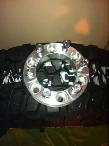

I was looking at getting some wheel spacers for my LJ 78. Is it safe to run these things.
tire size is 31 inch i am adding the spacers just for the looks nothing else but some of my buddies told me that its not safe as the nuts(tire)gets loose after some time.
Sorry if this is a stupid question, but I would much rather be safe than sorry.
Depends on the spacers...
You can get adapters which bolt to the hub, then you bolt the wheel to them.
Rather than using a spacer plate between the hub and wheel.. and use the original bolts....doing this leaves less thread to hold on the wheel.
That style could come loose.

Its true some have a problem with loose nuts and broken studs.
If you want that "bulked out" look,get some wider rubber and fit some fibreglass flares over the wheel arches.
Just get some wheels with more negative offset = wider stance and forget about spacers- IMO spacers arent good...... seen lots break apart.:cheers:
I second that motion:cheers:
Hi there, I've been running wheel spacers on my 75series for over 12 mths and haven't had any problems at all, after having my rear wheel fall off (prior to fitting spacers) I've learnt to regularly check the wheel nuts! They have never come lose on me, I run Seperior 1.5 inch spacers here in oz

Apparently, those spacers the OP posted up have a tendency to slide around, especially when mated with aluminum rims.
I use 5mm spacers on a 35" set of tyres and thats only to clear the brakes. Put correct torque on the wheel nuts and I doubt there's any sliding around.
