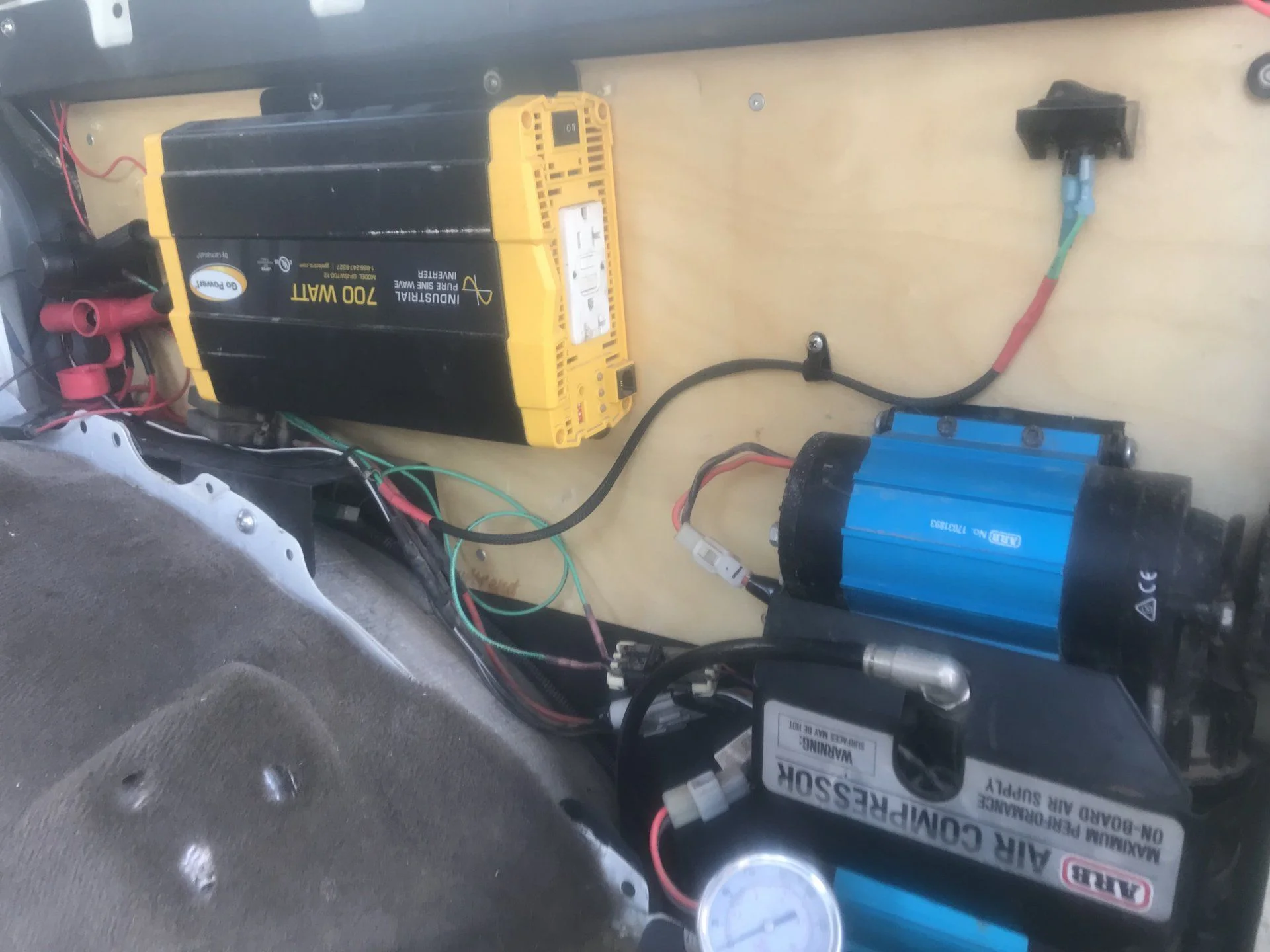

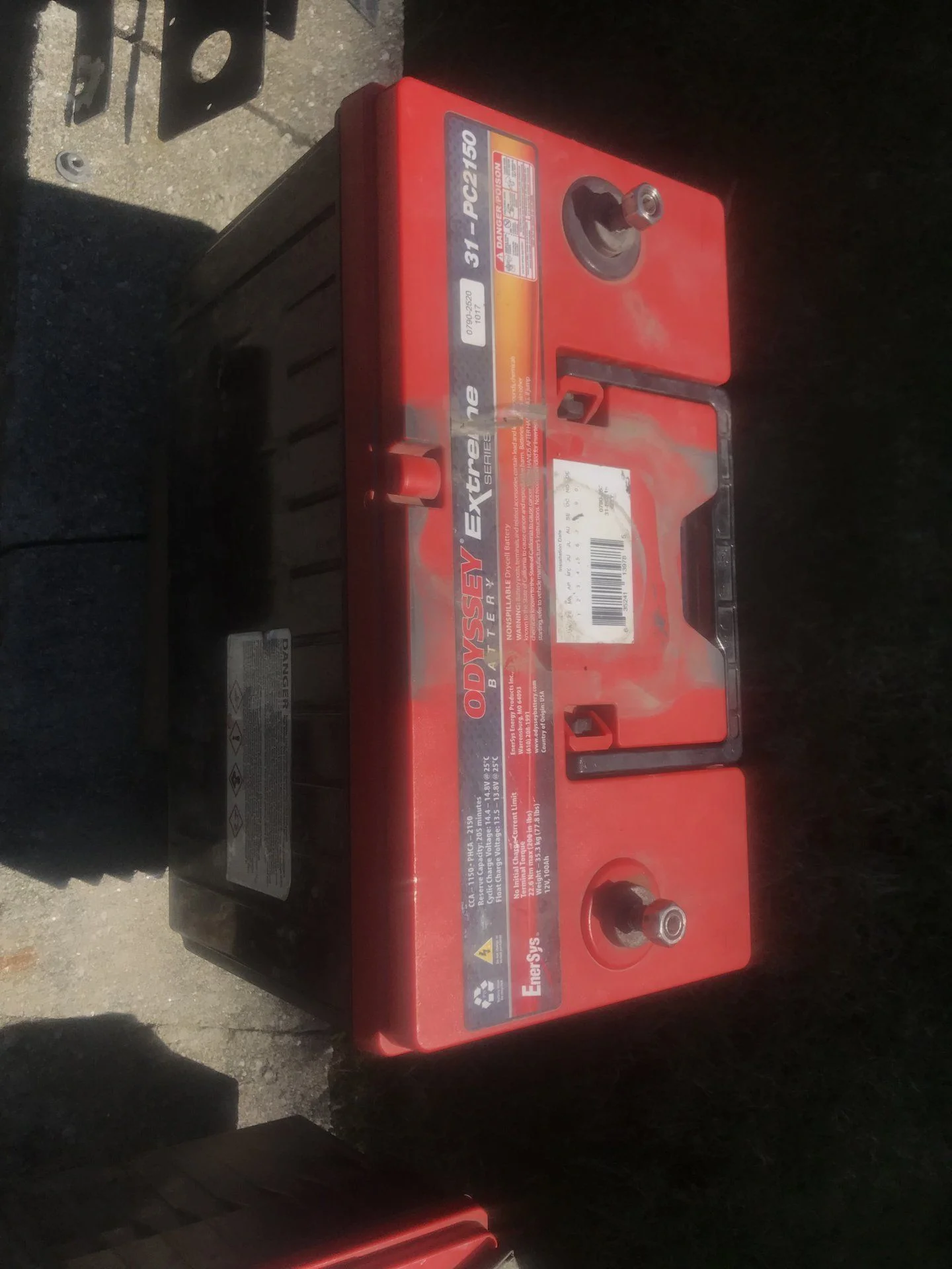

So I officially started my AGM LITHIUM battery system pulled my nationa Luna DB system out and yanked my 88 lb 100ah odyssey extremely and rewired for lithium in the rear of the 80 in a rear drawer system I’ve been building
ok lithium, redarc1225D and victron721 are all installed and to test it out drove out expo west and Im in Moab right now. works perfect the redarc has built in priority MPPT that the merlin solarpanel on alucab exped 3 is feeding. truck sat for3 days fridge running charging gopro nikon cell phone never went below 100% charged
