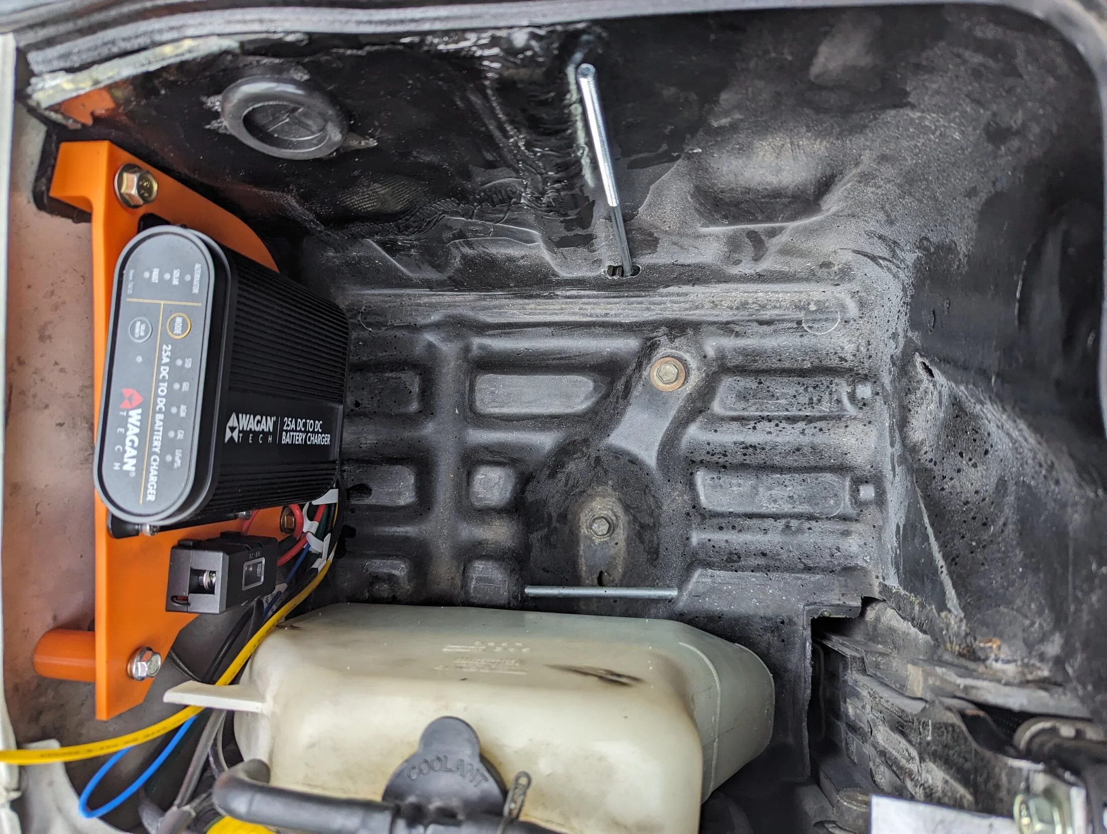

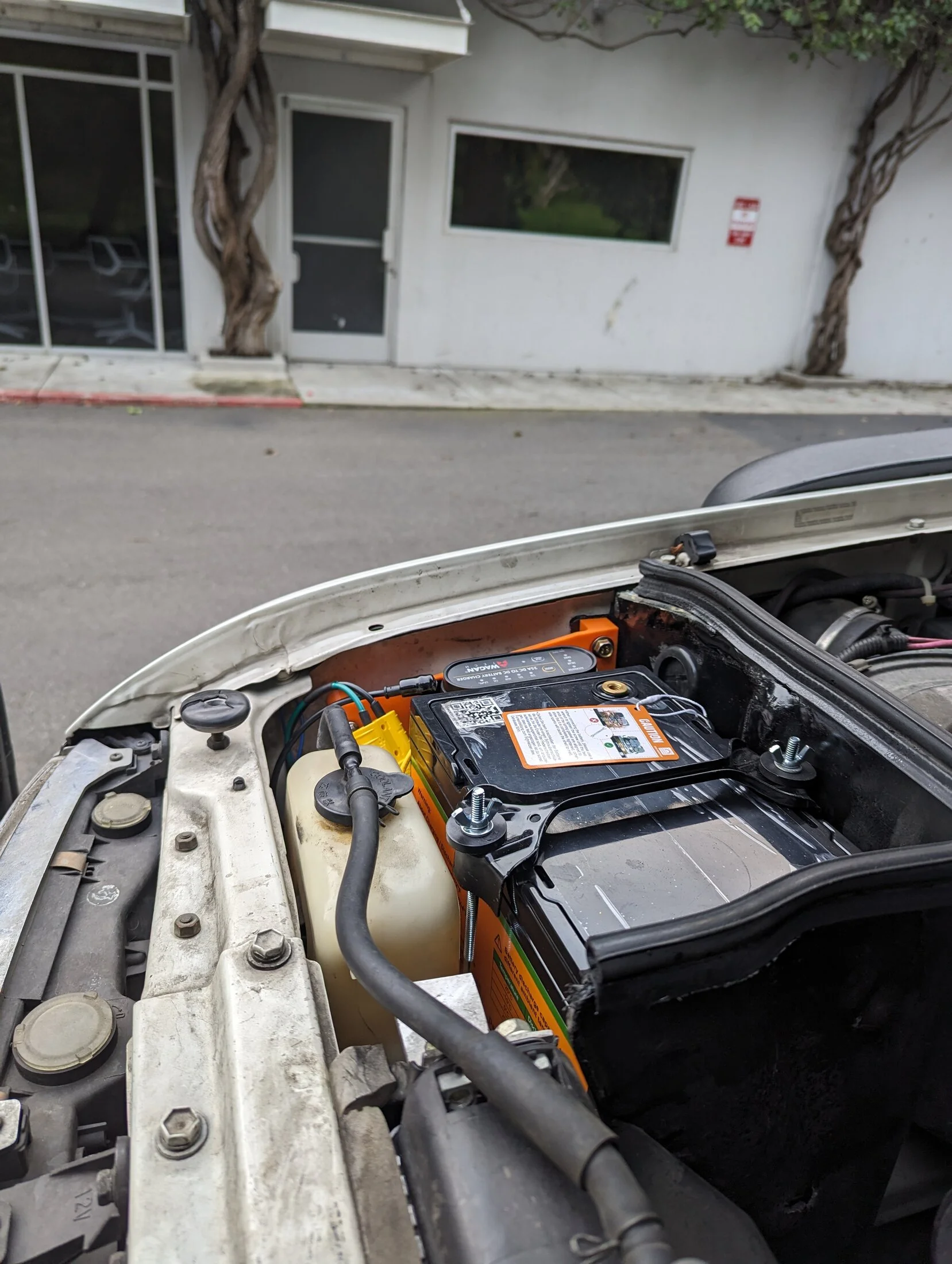

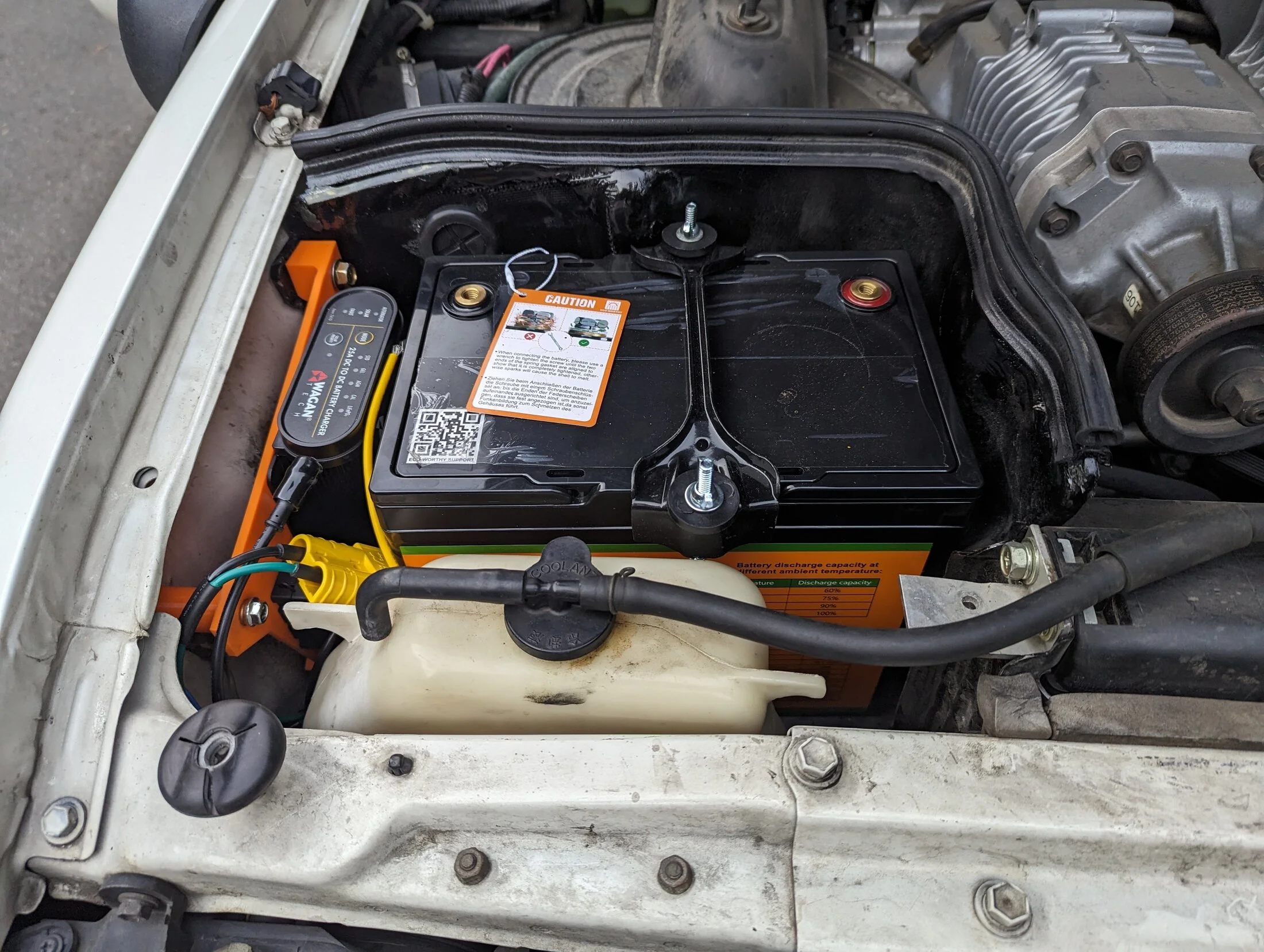

Setup in my 80. 3D printed bracket and 'upgraded' battery hold downs. Pictures during install - no with final wiring connected.
