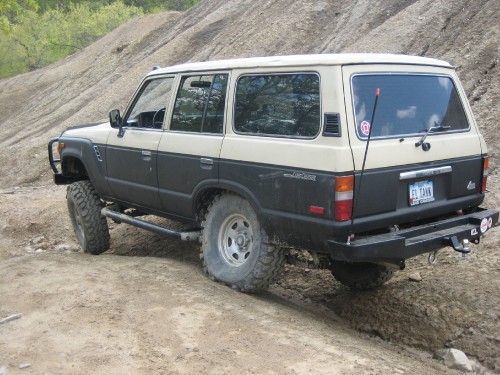

Does anyone have a tan or white 60 with bed liner on the outside? If so can you post pics.
I'm dropping mine off Sunday for LineX on the exterior. I haven't decided if I should leave the wood paneling (its peeling off on the drivers side) or spray over it. Nor have I decided where to stop the liner on the exterior. I was really looking forward to having this done. But now I'm afraid I'll f''' it up if I don't choose the right lines to follow. Whad do Ya'll thank?
just do the whole thing. my buddy has one that is forest green done all in line x and it looks bad ass. if and when i do it i will prolly try for a two tone and follow the bottom contour for the separation.
Pics by any chance???
Here's mine, got plenty more if you want.
OMFG! That answers that. Now... do i have to spend the extra 200 bucks to get all the wood paneling (vinyl) off, or can it simply be sanded to remove the loose material and then be sprayed on top of

That looks good, but when I get mine done, I'm going to have the guys follow the lower contour line. I want the protection, but I don't want my truck to have the two tone look.

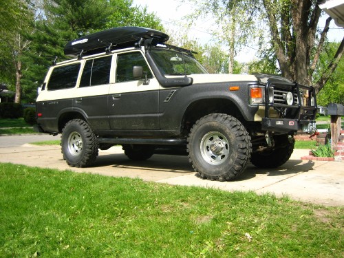

The lineX on your truck almost looks like the same color as my 60, its that dark greyish color. What color lineX is it? Also, is it really expensive to have done? They wanted $850 to do my interior floors black. Think I'll just get a DIY for the inside.
It's actually supposed to be black but in the sund it does end up looking a little lighter black. I had it done at my local Line X dealer here in town, the charged me $700 for the whole job.
