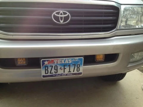

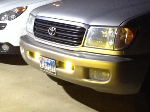

I bought the Rigid Industries D2 Driving set before OKC and I installed them right into the indicated holes in the bumper that Lx470iH8Mud points out, only on my 2002 UZJ, the holes were smaller.
I removed the plastic grill with a very sharp, heavy duty carpet blade and a hacksaw. Actually came out cleaner than I thought. Open the hood and remove the grill with the three screws. LIft up and set it aside. The mounting locations are two 3/8" holes drilled into the 2" steel tube behind the plastic. I chose to drill them at the center of the bumper opening BUT you will have to drill the holes 1/8 from the back edge of the bar to allow enough room in front of the lights for adjustment and covers.
I picked up two – stainless steel 2.5" carriage bolts that went all the way through the bumper tube and lock washers and nuts. You will want an 8" long x 3/8 high carbon bit for this work. You'll have to play with the bracket to ensure it's set up correctly before installing with the long carriage bolt through the bracket. The side hex nut mounting bolts included are a little tricky to get started but you'll need them installed before you set the lights into the opening. Slide the assemblies into place and slide the washers and nut on. A little tricky to do but patience counts. Tighten the lights up and proceed to the wiring. Stretch out the wire harness and run wiring down to the lights then upward to the firewall. Drill a hole in the firewall and use a self-tapping screw to mount the relay. Lay out and attach your wiring but I wouldn't lash anything down till your done.
Now, find the grommet that passes all of the wires through the firewall under the brake master cylinder. I had a previous wiring hole already in that grommet (Of course if you know of a more waterproof way of doing this please share). I then used a household fish-tape from the interior switch plate out to the engine compartment to pull the wires through to the switch. I drilled a hole in my switch plate near the mirror switch plate that was empty and attached the wires and after attaching power wires to the battery posts, I was in business.
I will say that I had a car and an 18 wheel want to road rage me over the lights on the 400-mile trip but these lights are small, and incredibly bright at 3000 lumens. Visibility trumps that halo-eyed BMW all day. The driving LED's are in elliptical 6-up boxes that direct the beam forward while providing flood lighting. They're a perfect solution for a stealthy install for us grocery getter/part time mountain folks that need to see the deer first. At $280, the lights are a great deal. I don't know if you really need the 11" bars at all now and I was set to put a 22"er on the top of the bumper. This is a great solution. Pictures to come. I just bought a set of amber covers which firmly snap in place for the foggy driving of Austin's winter. Those damned LEDS lose no intensity but I think I'm less likely to get pulled over for the glare. Feel free to ask me for directions.
