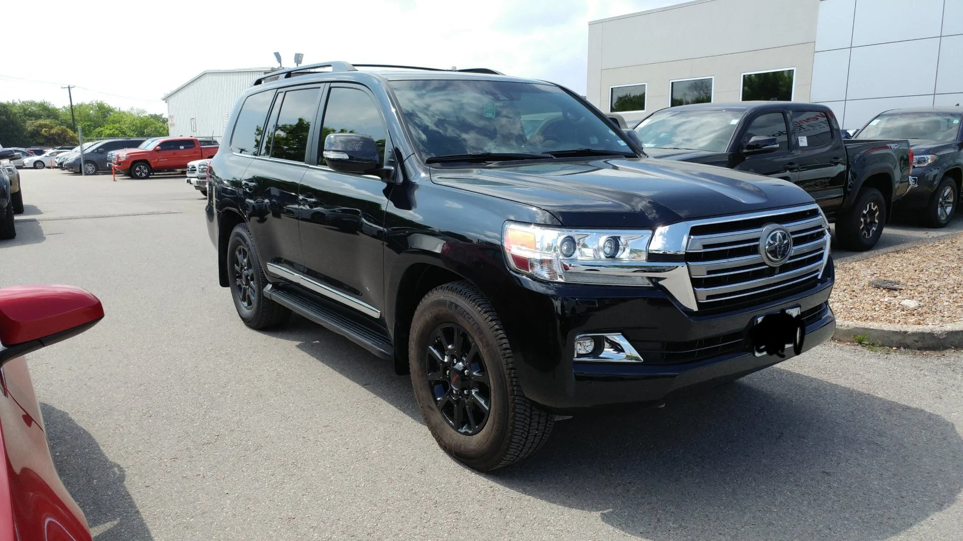

I have a 16 with trd pro wheels with no lift. 275 70 18. No rubs.
Wanting a lift but waiting I guess.
