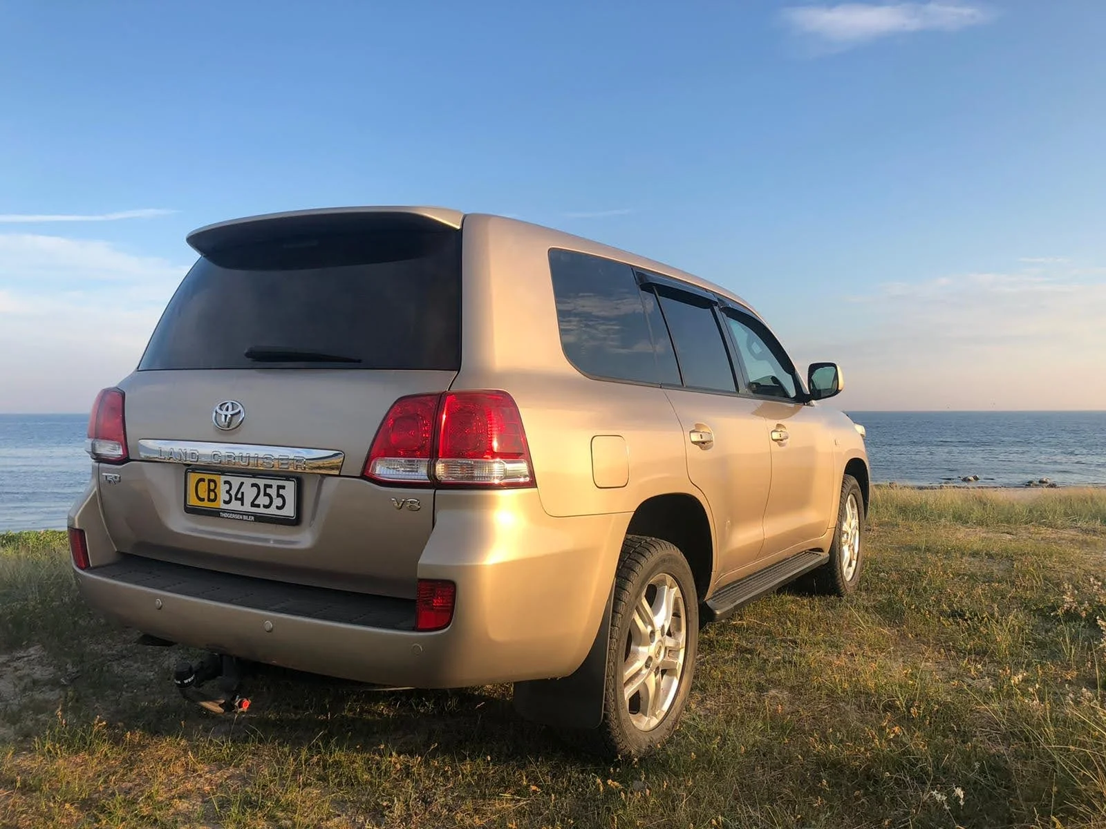

I bought my LC 200 V8 turbo diesel 286 hp from 2010 6 month ago, now i bought a constant load lift kit from ironman, as i had on my LC100, very satisfied with it, but my old LC100 did not have this AHC on it as my "new" LC200 has, so my question is.... What did you guys do with that system, delete it all or what can you do??
And a pic of the 200 from the cold north in Denmark
