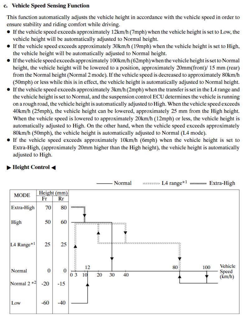

I definitely think I went wrong somewhere. I wasn’t as scientific with my approach, and simply maxed out the sensors on all 4 sides while in high mode/AHC off and truck turned off. It doesn’t seem to have any change and in addition to no lift, at highway speeds when the LX lowers, it feels like the back almost lifts itself even more and then drops. I was debating getting on flat ground, setting back to the middle, driving around and retrying the whole procedure.
just for reference, I feel like my rear shocks stiffen and then drop when I reach 65 also. I always thought that was normal.
The nose drops first and then the rear.
I never feel the nose drop on highway, but the rear is always noticed.
Sadly it doesn’t happen much for me, local free ways are 60 posted and with my 10% gear inflation 5 mph over 65mph cruise reads 59 on the Speedo.
