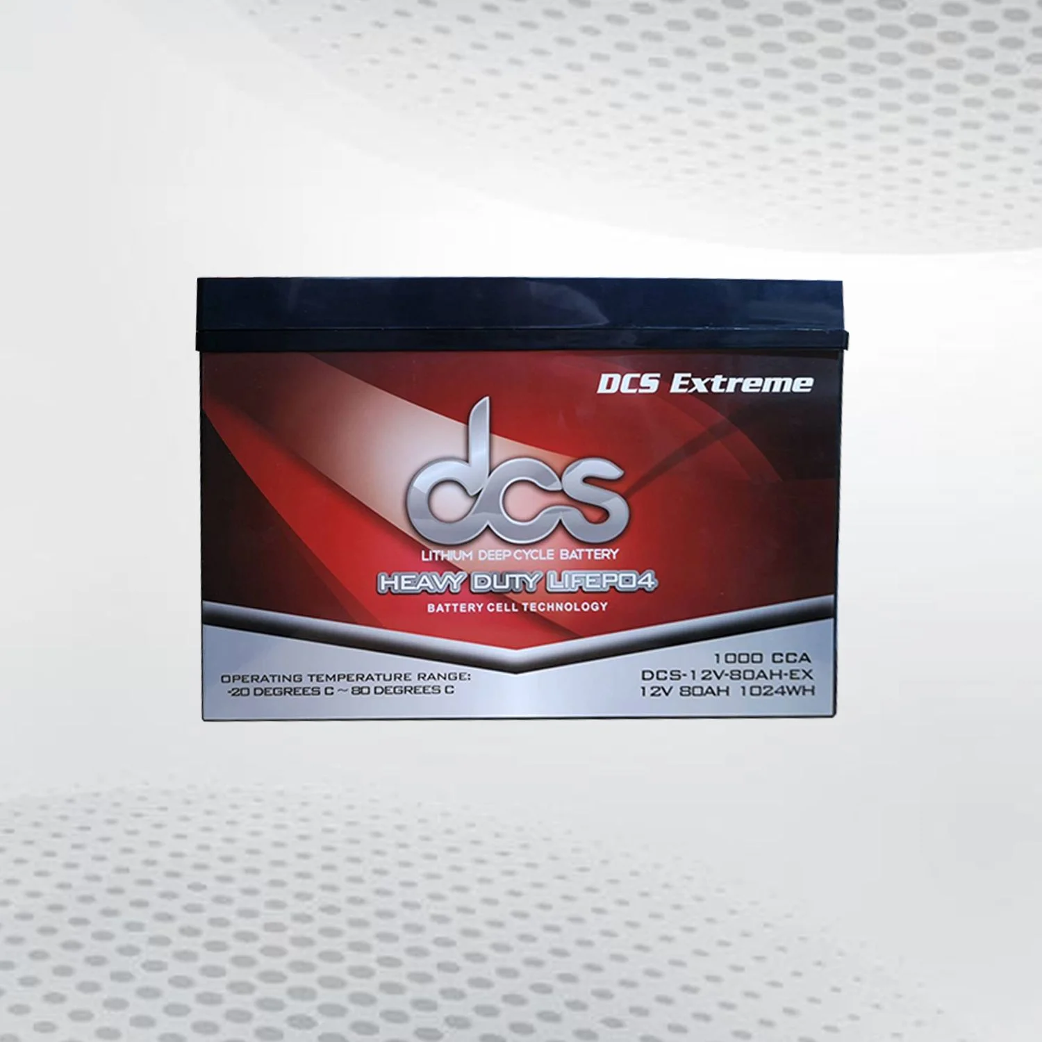

This looks tasty..
Aussies get all the goods
