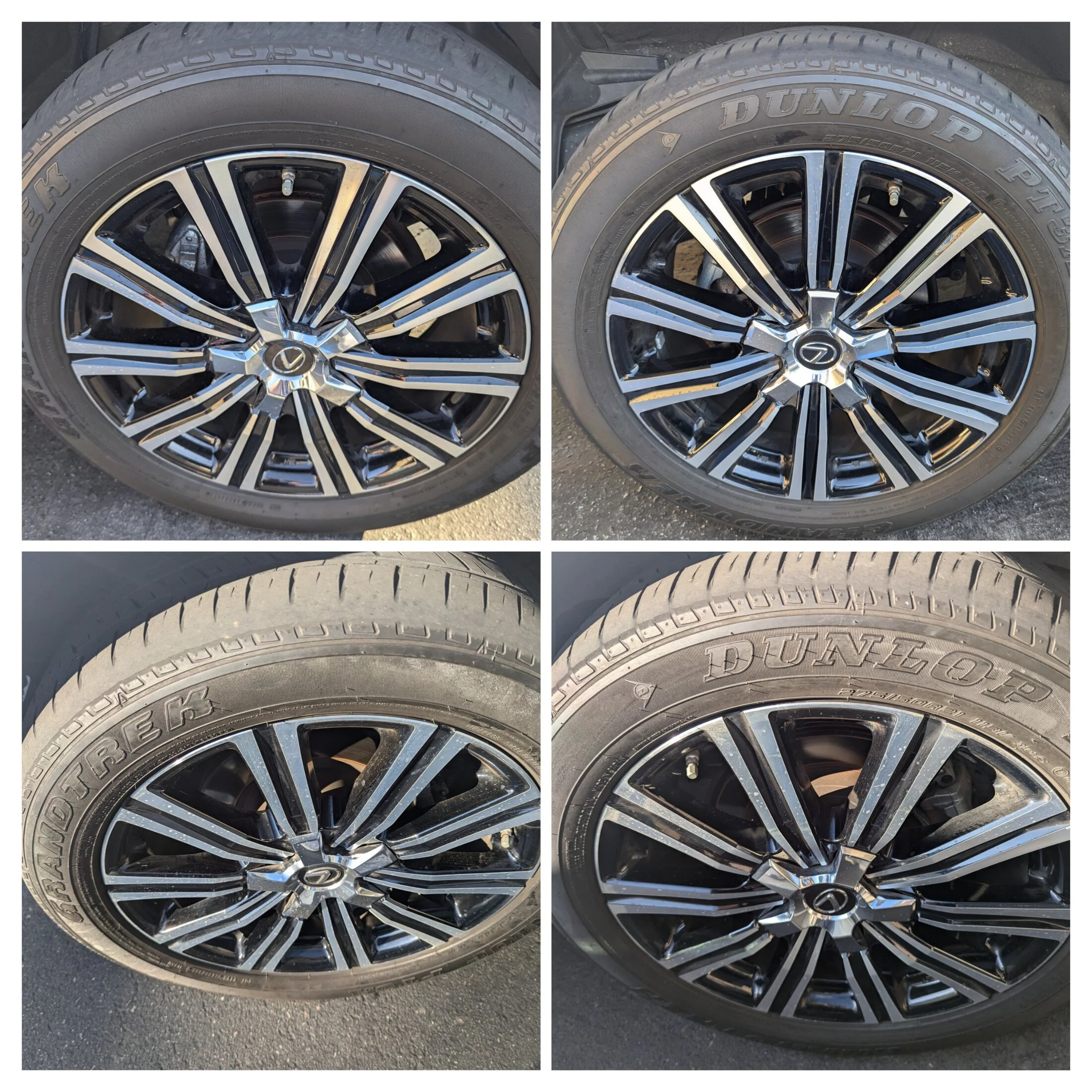

I've got lifetime alignment from Firestone. These 21" are starting to wear unevenly in the outer perimeter edges. See picture. Currently 20k miles on these tires and issue started occurring around 15k miles. Firestone guy says vaguely it's because these are 21" and they just wear out. I don't buy it. With periodic alignment, why is this happening?
I've got lifetime alignment from Firestone. These 21" are starting to wear unevenly in the outer perimeter edges. See picture. Currently 20k miles on these tires and issue started occurring around 15k miles. Firestone guy says vaguely it's because these are 21" and they just wear out. I don't buy it. With periodic alignment, why is this happening?View attachment 3804332
What's your driving style?
Maybe some under inflation and could use some more regular pressure checks.
Any mods?
Makes me wonder about the accuracy of the alignment machine at that Firestone shop. Might be worth paying for an alignment and second opinion somewhere else. Do the tires have the same heavy wear on the inside edge?
Outside shoulder wear on regularly rotated 21" tires (more like rubber bands).
How often are tires rotated?

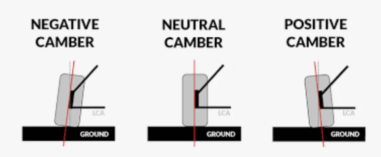

A) What is the camber reading at "N" ride height on alignment report? As the truck goes to "H" mode, the camber on front tires moves positive putting more stress on outboard shoulders. Perhaps the front ride height sensors are a bit out of adjustment.​

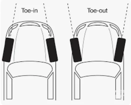

B) Excessive toe-out prematurely wears outer shoulders.​

Update: 1/3/2025: I went into Longo Lexus to do another alignment and front Toe measurement is materially off from what Firestone had. Lexus aligned it. See report. Comments? also, are shops certified for their alignments, meaning how do I know if it's calibrated?
