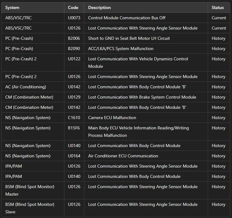

Hey all,
Had a GX460 inspected and after clearing the codes - 30 min later these are the codes it is throwing. Is it most likely battery or potentially electrical issues? Car appears to be mint, 2016 with 55k km's, summer car that was rarely driven, overall in phenomenal condition.
Everything is functioning fine and no error lights or CEL.
Have you disconnected the battery, let it set for a couple minutes and reconnected again?
Yep, the codes above are what came back after clearing (with standard OBD not techstream) and disconnecting battery.
The battery is old though, 9 years now.
Do you have another vehicle (or friend) with a newer battery you could swap with, just for testing?
unfortunately no, going to replace the battery to confirm before finalizing. thanks!
Most auto shops, e.g.: Auto Zone, O'Reilly's offer free battery and alternator testing.
